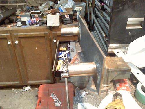

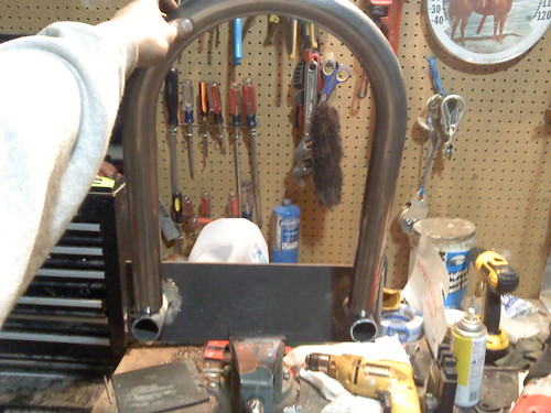

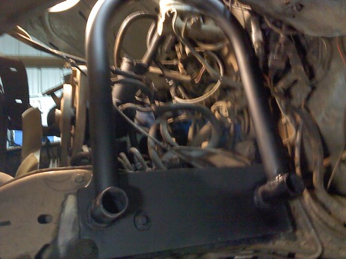

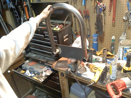

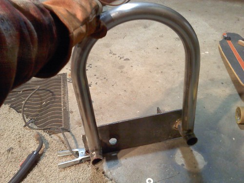

Started working on my shock hoops and bracket to attach it to the frame.

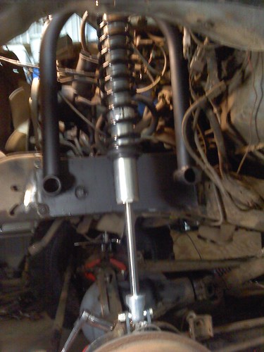

Driver side hoops all welded on and coilover is in place for the moment, I need to get them charged and put my lower coil on.

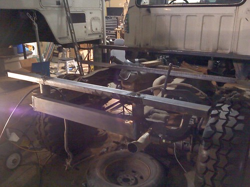

My new transmission crossmember.

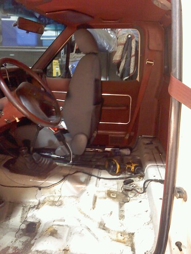

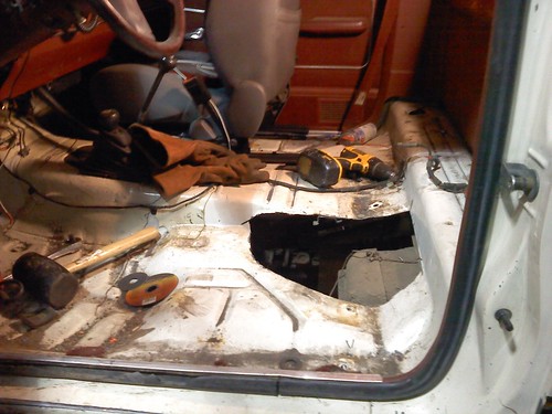

Took out the old seats and carpet.
Started doing a little cutting to make the new seats fit.

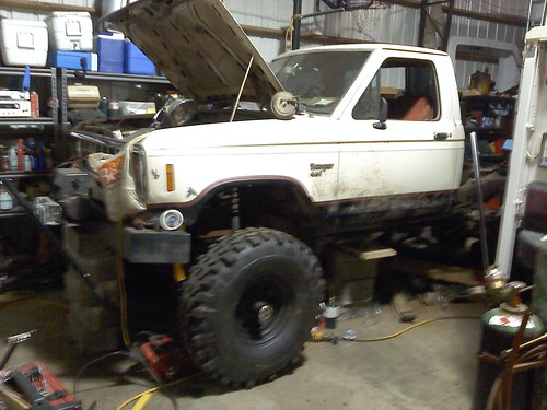

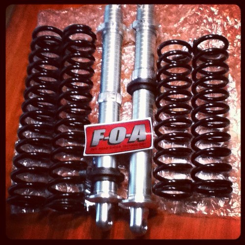

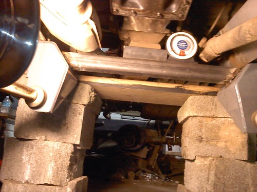

Coilovers in and its sitting on its own, no more cinder blocks holding it up.

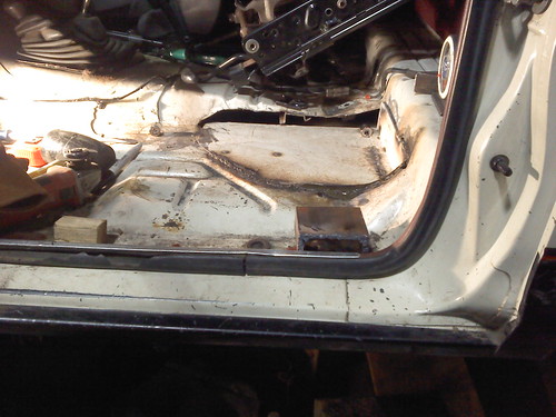

Worked more on the flatbed, I need to draw up where im going with it. And worked on welding up the hole I made in my floor.
Its all good.
So im at a stand still now since my passenger side coil over decided to start spitting fluids out.
