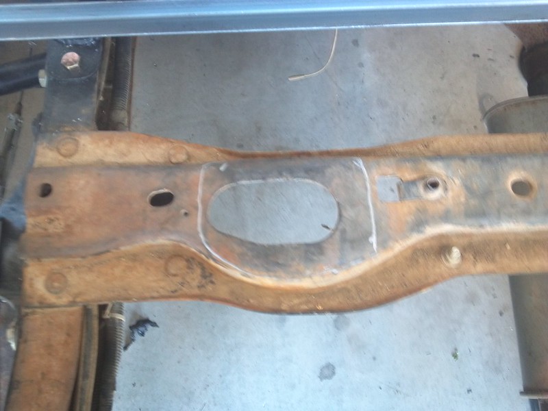

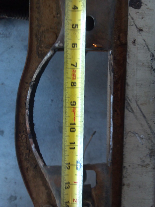

Was double checking some things for my new rear driveshafts and she decided she wanted to help.
2014-08-05_20-05-43_452 by dresselhausfc, on Flickr

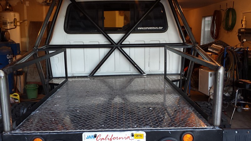

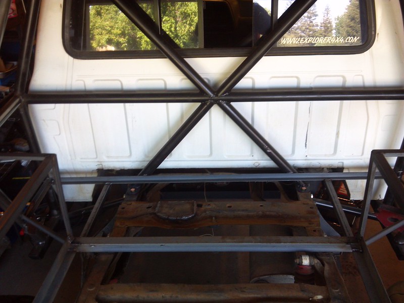

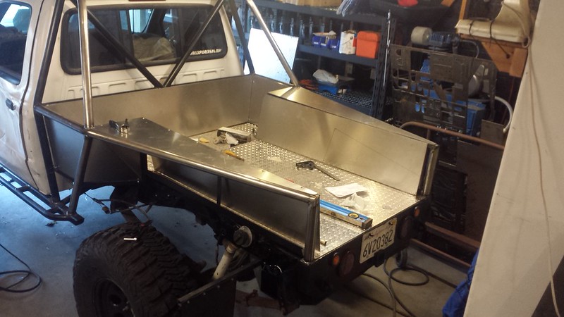

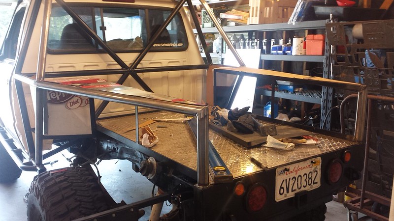

Got a little time to work on the bed. I had this 1/8" aluminum diamond plate left over from an old job so I am using it for the floors of the bed.
2014-08-06_17-48-39_609 by dresselhausfc, on Flickr

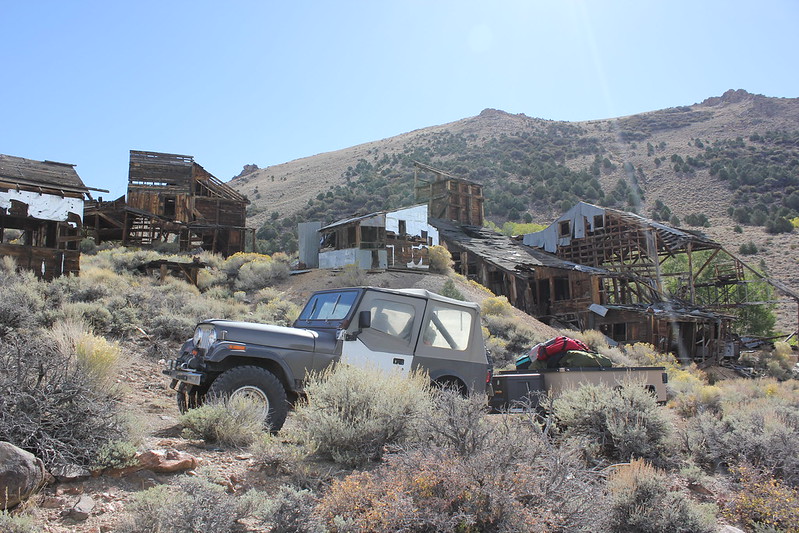

Haven't touched it in 2 months. I cut some aluminum plate for the bed floors and that is all I have done sense I updated this. we did take my wife's jeep over to Bodie for 4 days and had a good time.
IMG_9407 by dresselhausfc, on Flickr

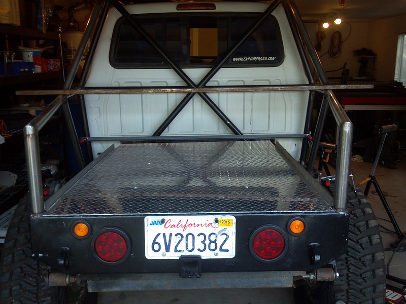

Finally got a chance to work on the truck for a few hours today. It has been over two months sense I have touched it. Cut and drilled all the pieces of aluminum that make up the floor of the bed. I need to get material for the rest. I am thinking 18 ga aluminum but am open for suggestions if something is better. Really would like to have a bead roller for the sides but it isn't in the budget right now.
20141102_160950 by dresselhausfc, on Flickr

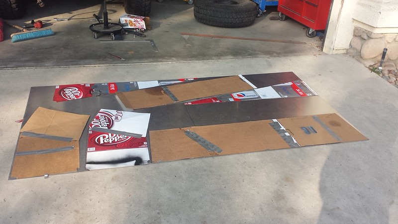

I started out by making cardboard templates of the panels I needed for the bed.
20141105_105402 by dresselhausfc, on Flickr
Once I got all the pieces made in cardboard I laid them out on a sheet of 18ga Aluminum to try and get them all to fit.
20141106_083416 by dresselhausfc, on Flickr
