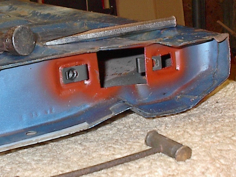

I don't know how the 2011 tailgate metal is stamped out. On my older 1984 tailgate I got around missing and stripped stamped nut inserts by cutting a slot so that nut clips (J-clip, U-clip) could be used:
The problem on my older truck was the big square holes where the nut inserts were. Again, I don't know what you are having to deal with on a 2011, so I don't know if the holes in yours would be small enough to work with rivnuts.
