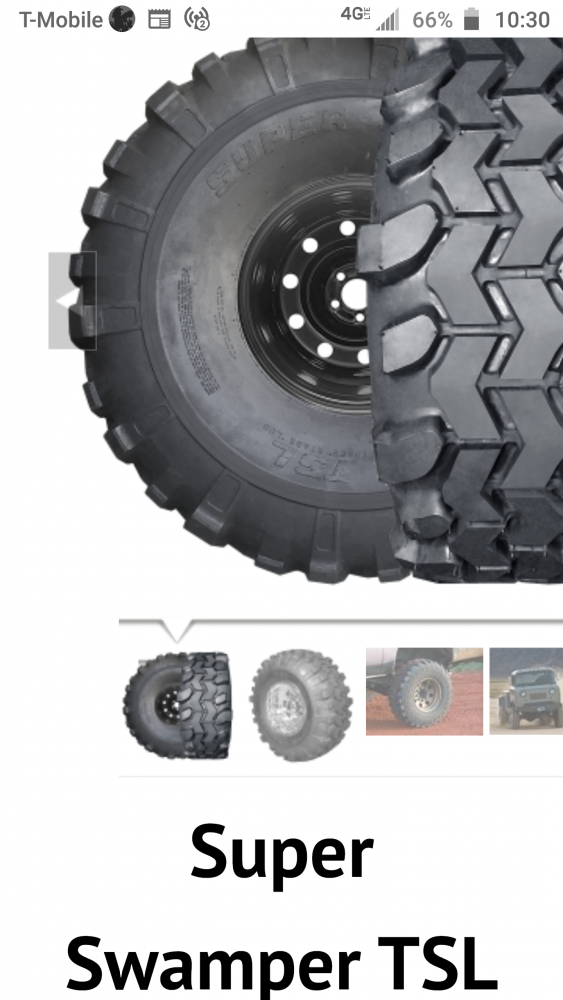

As far as tires go, if your still in VA and planning to off road I like these;
Interco Super Swamper TSL Bias, SAM-12
I used to be a died in the wool radial tire fan but these past 16 years I've had nothing but bias plys and really like what offer to the driving experience. They just seem tougher and feel better driving on.
The Interco SS TSL Bias is well suited to abuse, wet, snow, dirt and mud. Sand...not so much. They will hold their tread a long, long time.
Despite my Interco speel I am currently using Mickey Thompson Baja Claws for wet and Baja Belted for dry; where I live, the belteds are almost a liability, unless I'm in the dunes, then, they are KING!
I had a very good experience with a set of Pirelli's Radials for primarily road driving; the set has over 80kmi on them with only approaching half tread depth worn. Their rubber compound is perfect for cool/wet, translation, the Pacific Northwest.

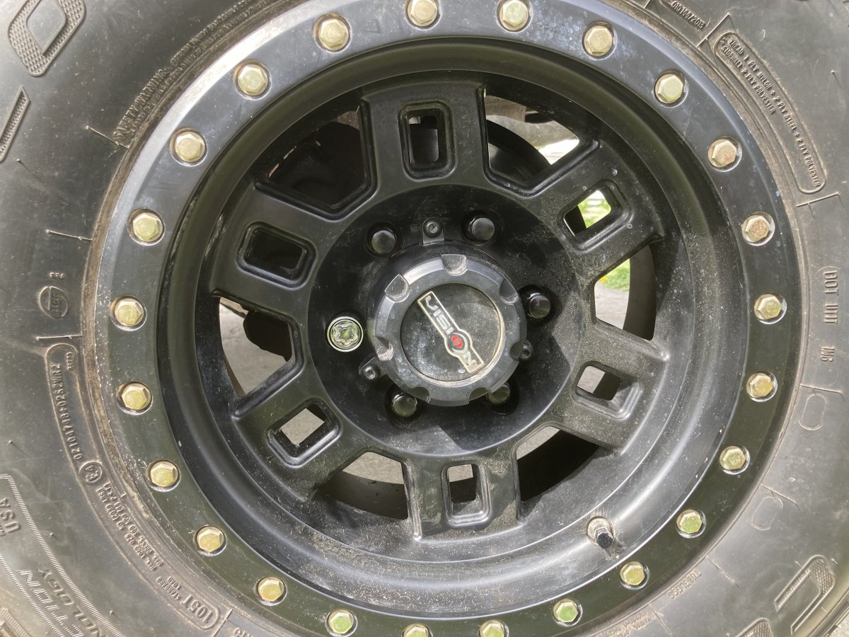

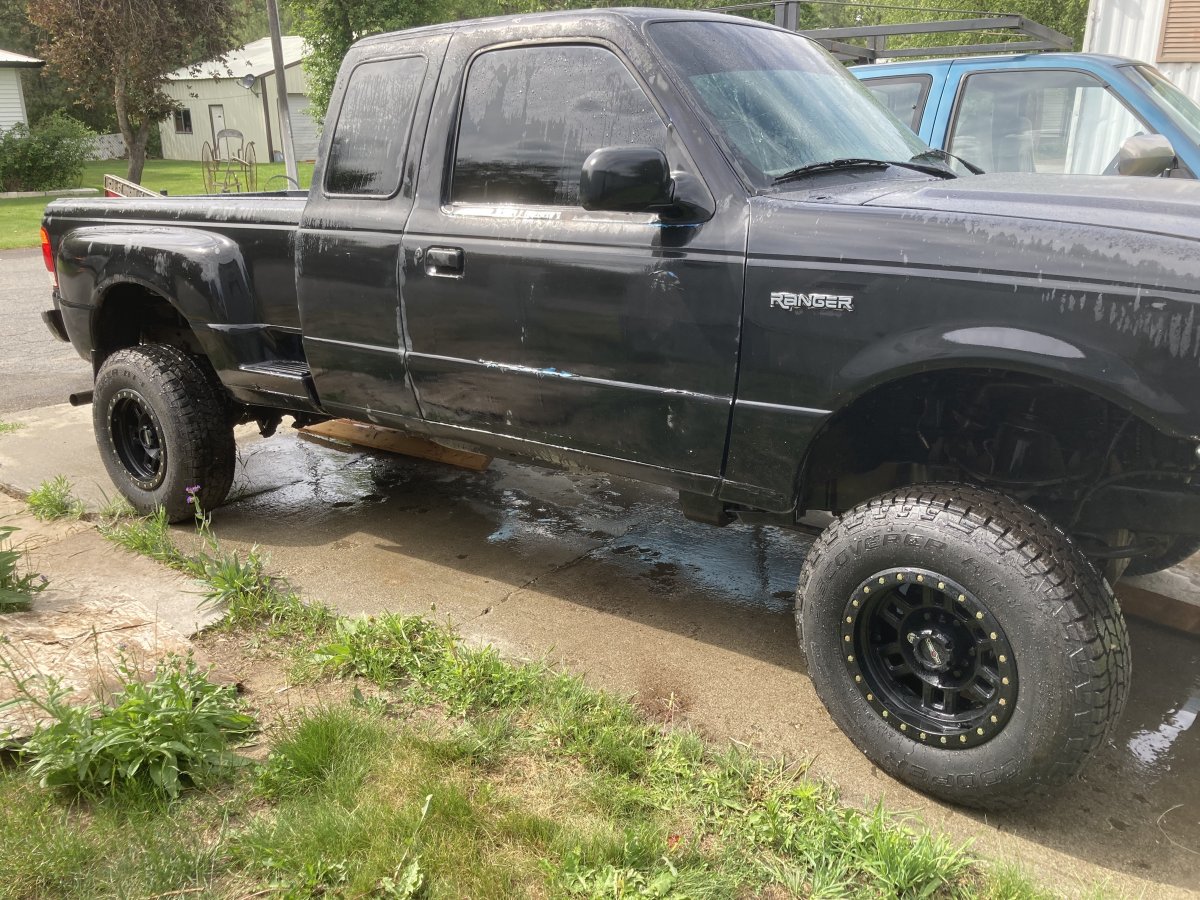

If it’s 4x4 i honestly like 15s maybe 17s but this is what I went with but I still haven’t decided what tire or what size I’m gonna go with for them oh and 17s you have a lot better options as far as finding used tires
