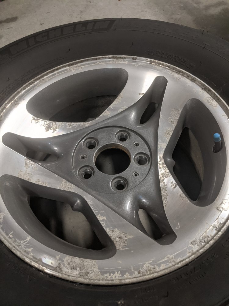

Any ideas on how to give these rims a second life. My first idea was to strip the clear and sand them up nice. then hit them with some black paint.
Any easy ways to strip the clear and deal with the corrosion?

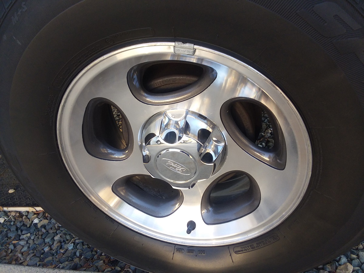

I like stock wheels, cast and steelies, and I'd rather rehabilitate and preserve original, versus replace with new.
Steelies usually turn out really good. I've had so-so luck with refinishing OEM cast wheels (it has gone better with each set that I do, though).
Just sanding and clearcoating didn't do near as good as first using a stripper to remove the original clear (I used Aircraft Paint Remover Aerosol).

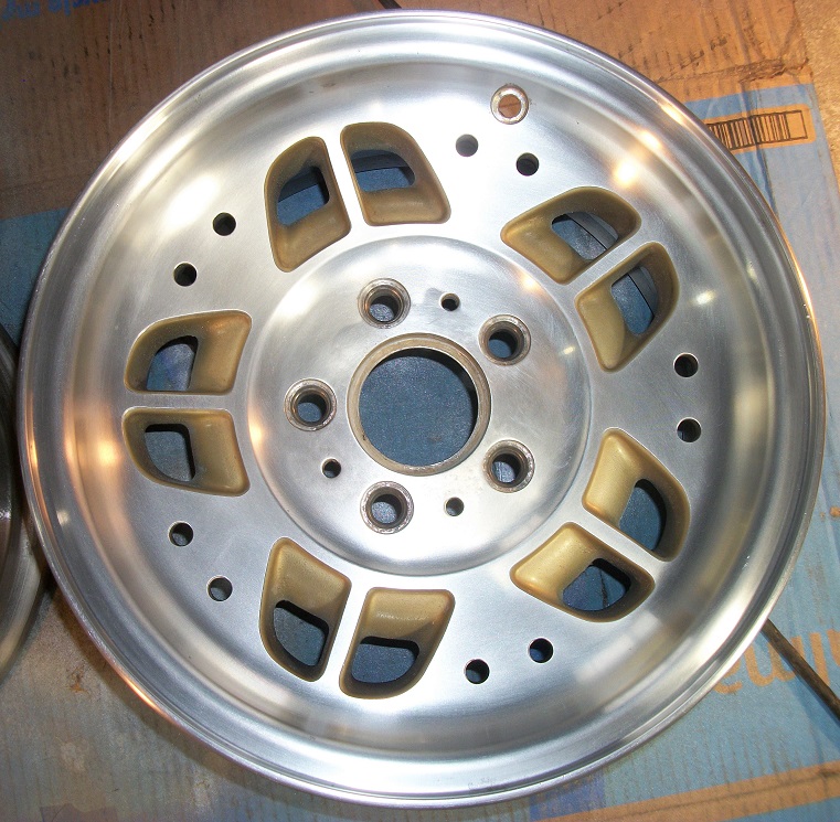

Deerprints like these that I refinished last have fine lines, like a machine turned surface, and I found that very course sandpaper rubbed with the lines did a lot to hide most of the corrosion stains. I then used wire wheels in a drill, and scothbrite pads, to help even out and polish the finish, before giving them a rattle-can clearcoat.
Not perfect by any means, but I think it's worth the effort if you're trying to keep an original old truck more presentable. It can take a lot of time and patience, learning as you go, and as always "your mileage may vary" . . .
Before and afters:
72767
72768

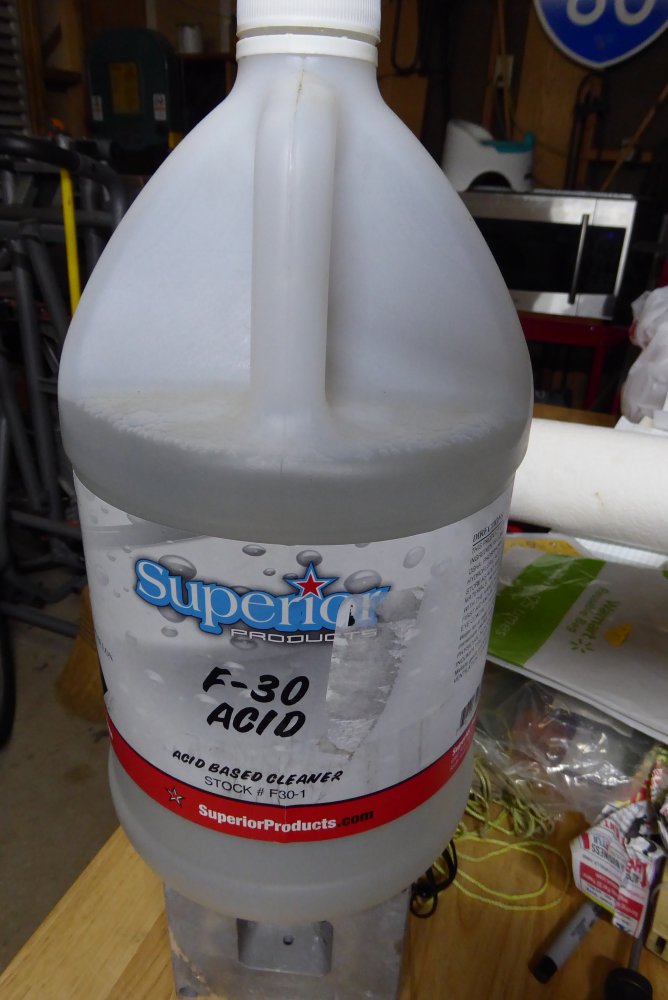

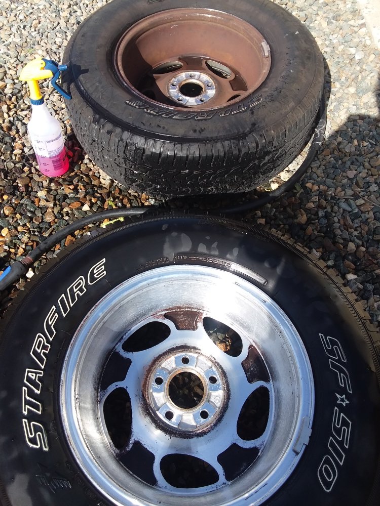

What acid are you using specifically? I've got a set of aluminum wheels I'll need to clean up soon.
It's just generically called 'wheel acid' and used by detailers. Mine was made by Superior Products and labeled F-30 Acid. I use it first to open the pores on the clear coat which makes the Rustoleum Aircraft Remover work more efficiently. O'Reillys carries the acid and Walmart or Home Depot sells the Rustoleum Aircraft Remover. Never use the acid full strength, wear chem gloves, eye protection, and don't let the diluted acid get on any glass, it will etch it. If there's lots of brake dust full strength Purple Power with a stiff brush does a really good job as the 1st step in cleaning the wheels. I used the same 2:1 water/acid mix to remove 15 years of serious hard water spots all over the truck, worked great with no clearcoat damage at all.
