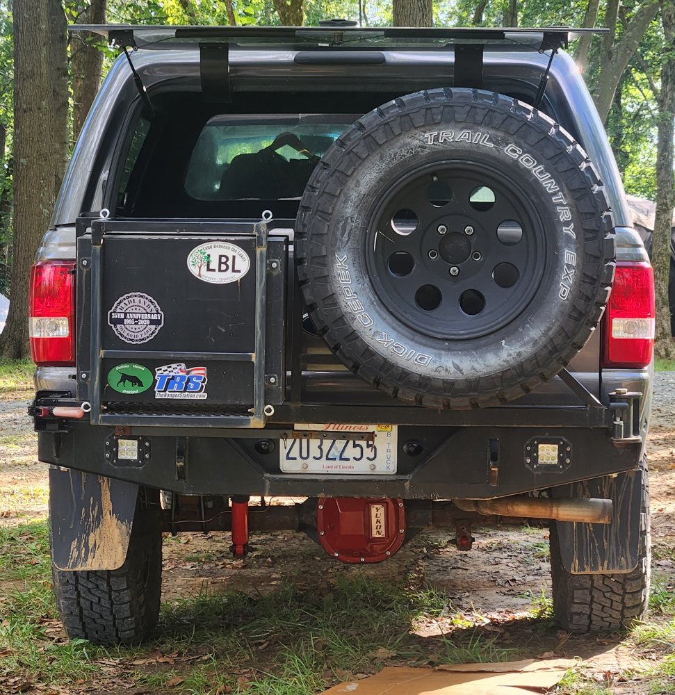

I did a swig out tire carrier to carry a full size spare...
Love that swing arm... Actually everything there looks great. I'm actually thinking I could stand the tire vertically between my tent and the rear window without issue.
