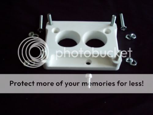

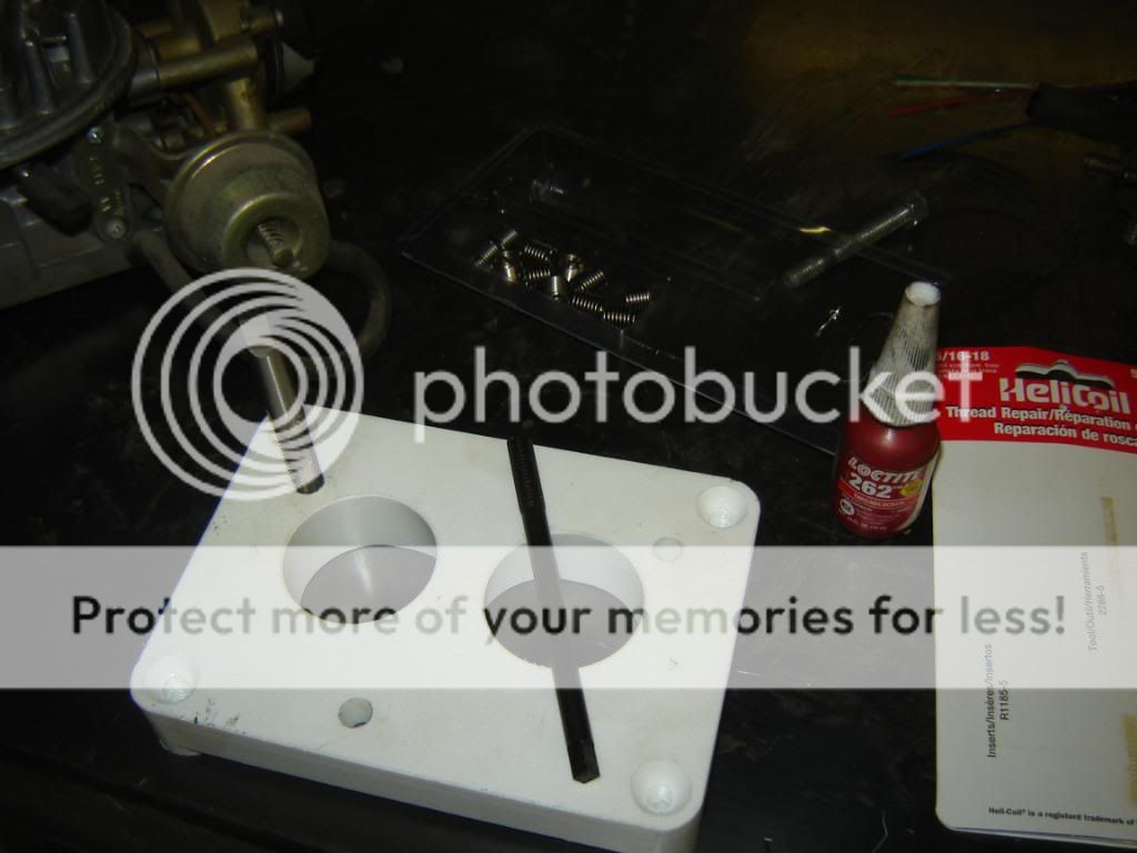

found this on ebay. gonna get it and see if we can use it upside down. it's an adapter to mount a holley 2barrel carb onto a tbi chevy. if it works we wont have to get one made.
I think we're gonna fiddle with it this weekend.

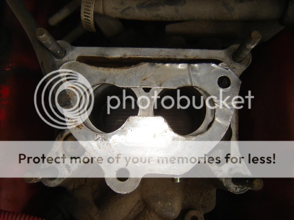

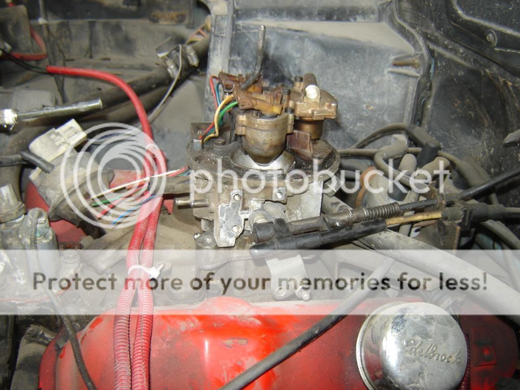

Here's the TBI sitting on the intake manifold.
The chevy gasket on top of the intake showing the difference in the ports.

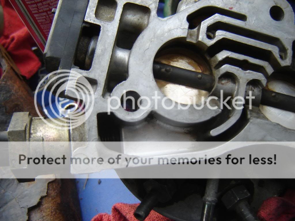

This bad-boy upside-down will connect the two.

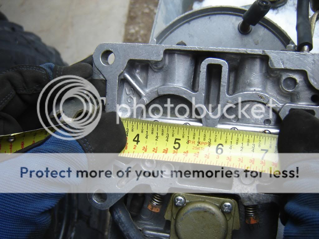

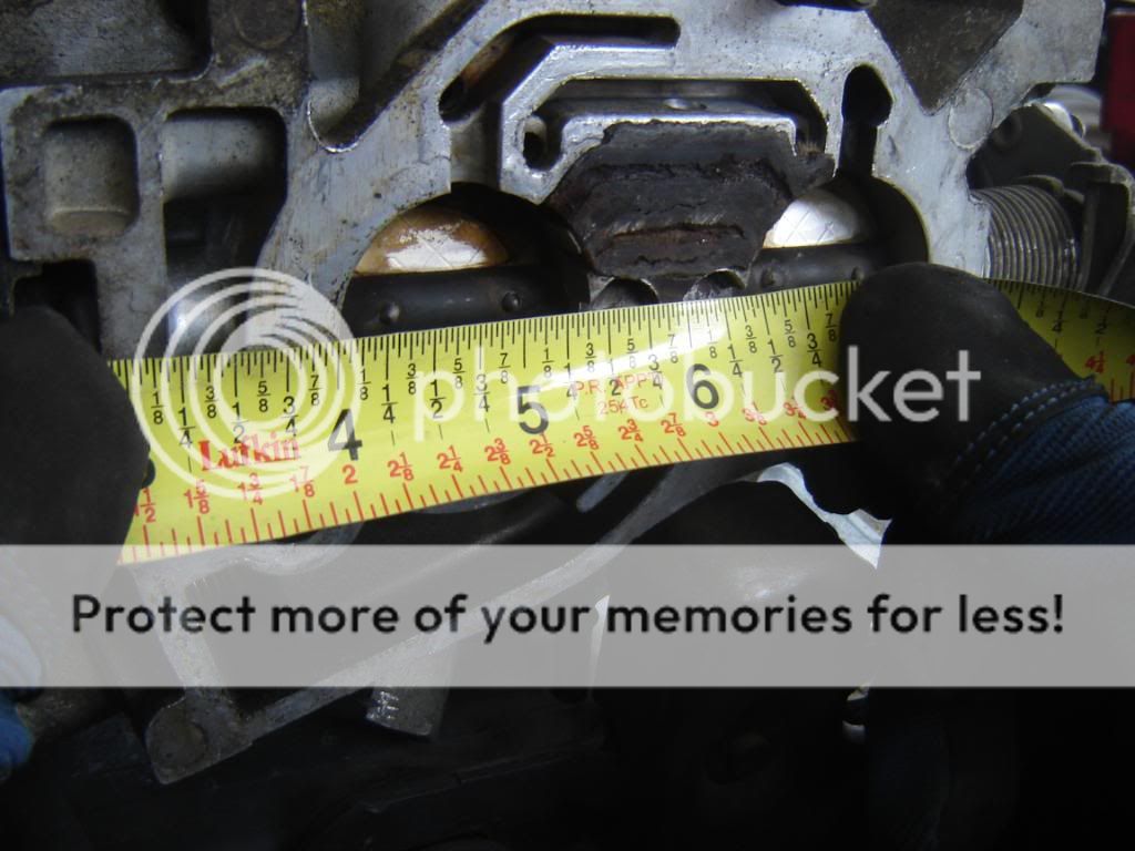

Side-by-side comparison of the butterflies.
Ford- 1 1/2"
Chevy- 1 3/8"

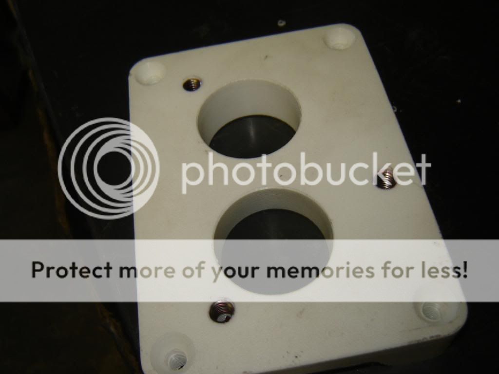

Here is this weekend's progress.

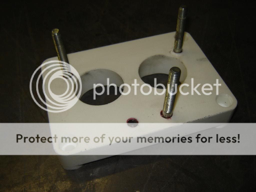

My adapter came saturday and we discovered that the threads were different. a tap and some helicoil solved that.
Chevy TBI studs in.
The Chevy thottle "nub" was not compatible with my B2's throttle cable so we had to swap the ford nub on to the throttle body.
The Chevy nub was rivetted on so a grinding got the job done.
Ford nub on the throttle body.

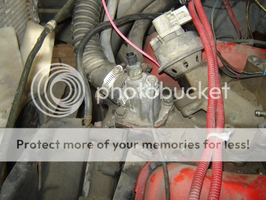

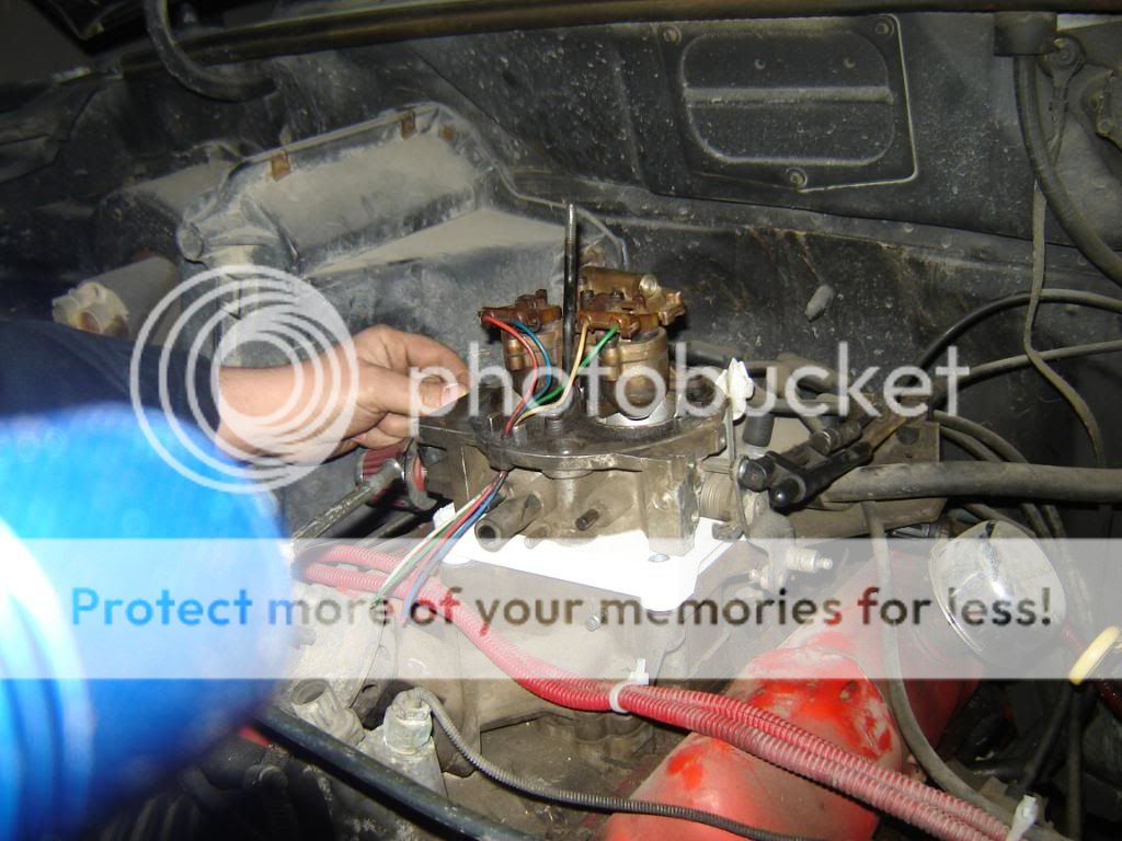

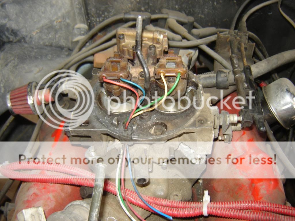

Here it is mounted to the B2 2.8.

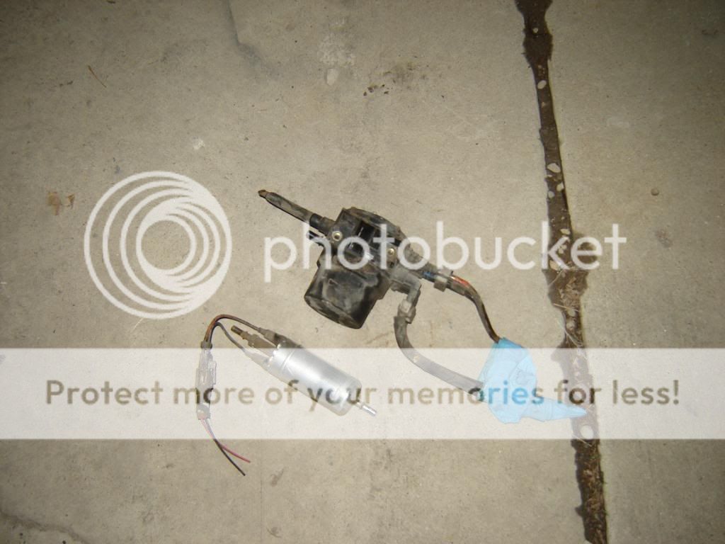

Also scored a fuel pump of a fuel injected F150 from the junk yard.

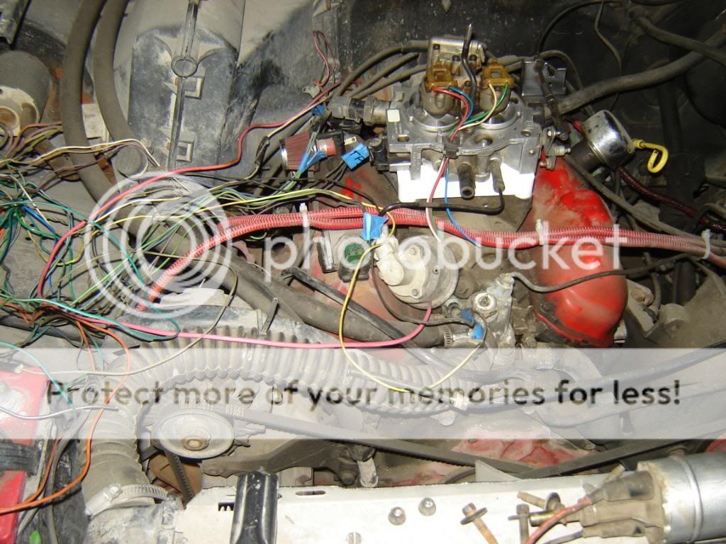

Making some progress on the harness.
Here is roughly how much of the Chevy harness we need. (there's probably some more stuff that can be cut out though)
The harness in the BII. (the computer will be mounted in the stock BII location on the passenger kick panel)

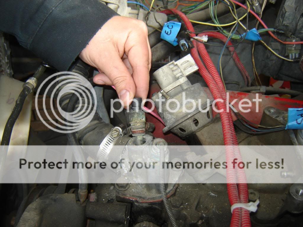

We found that the coolant temp sensor threads in perfectly.
