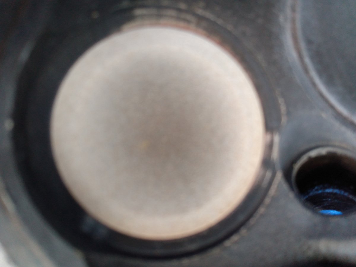

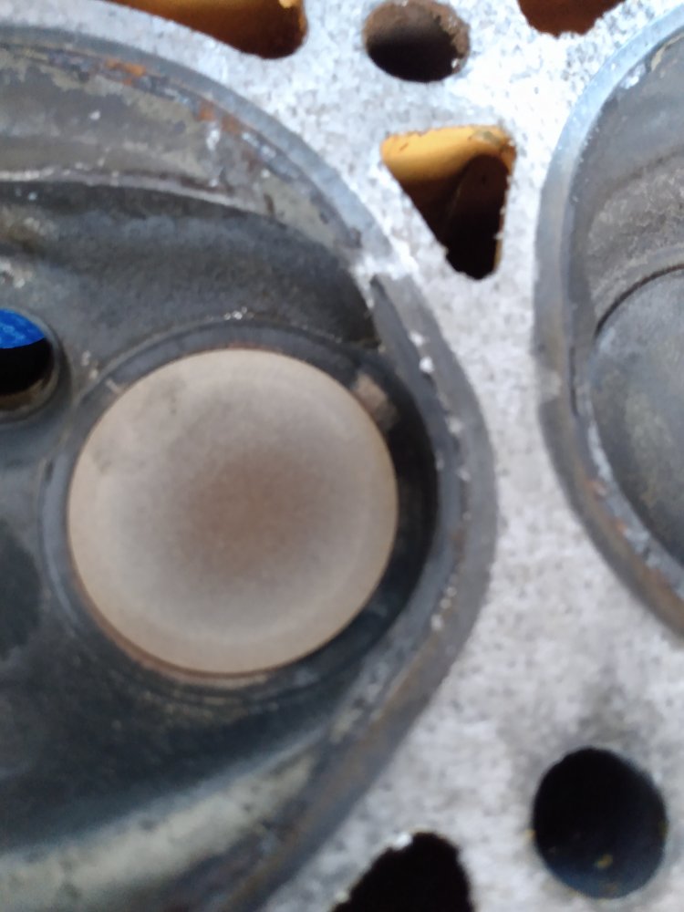

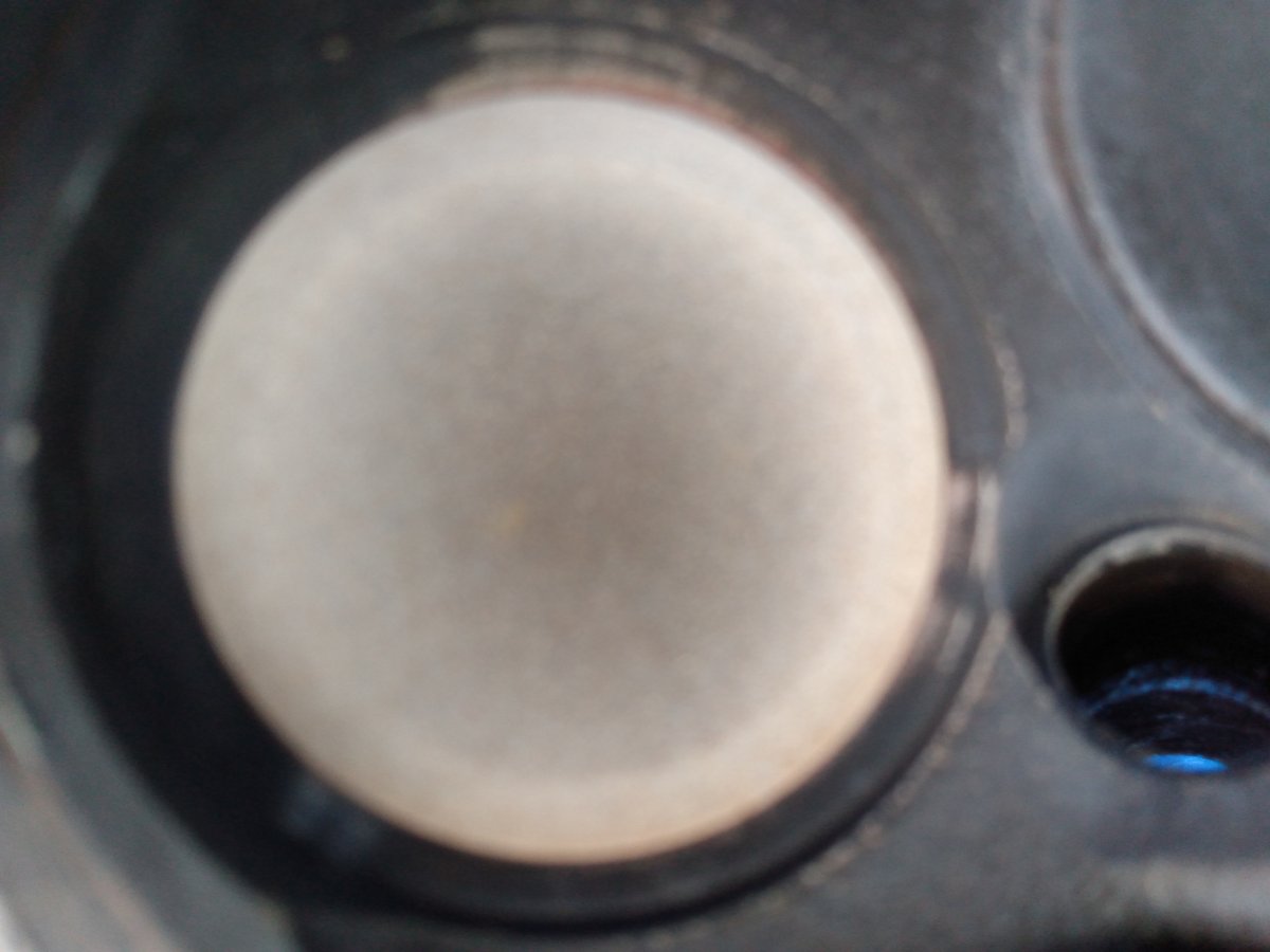

Here are photos of each exhaust valve, and both heads valve side up. Sorry, some are a little blurry. Any thoughts?

Not sure why you are stuck on the mechanical part of the engine for a rich condition. Do a compression check on the engine. If it's good, then move on away from a mechanical problem with the engine causing it.
Is 50 psi good for your setup? I am not up on all the different years and their pressures, but I know 50 psi is high for a older model fuel injection system.
