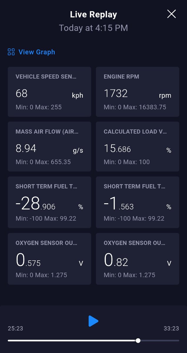

hi yall, ford ranger 4.0l (2010) throwing high voltage o2 code on sensor 1 bank 1. i replaced the o2 sensors 1.5yrs ago. not convinced its the sensor. it does fluctuate and come down in voltage, but is generally higher than bank 2. intermittedly sticking at 1.275v.
on hills, accelerating, or where i need a bit more power, the truck looses power, sometimes itll kick back in if i keep giving it gas. cat temp is normal, no visible damage. ive replaced the fuel injectors on bank 2 a couple yrs ago (new cylinder head) didnt do bank 1. also replaced the maf at the time. as well as the fuel pump and filter. (and throttle body sensor, and egr sensor)
now, watching live data, i see bank 2 is occasionally zeroing out. 0v, 0% fuel trim. some times while the other side is going high. maf is sometimes running a bit higher than i would expect but nothing insane. seems compensatory.
and to update, today while live data reading on a drive, it bogged down really bad, but the o2 sensors were reading fairly normal, maf fairly normal, not a huge load on the engine, but the bank 1 short term fuel trim froze at -28%. lasted for about 30s. i had to gear down from 4th to 2nd , give it some higher revs (2500+) to get it to kick out and be somewhat normal again.
i was starting to wonder if it was a stuck open fuel injector, vaccum or air leak, or maybe the maf. but this really confused me. could it be wiring problems, the ecu?
attaching a screenshot of that moment for context.
any insight into this?

in the screenshot: left side is bank 1, right side bank 2
AND no misfire codes. that ones really got me wondering. it feels stutter-y and unhealthy at times, like its misfiring. anyway the ecu could some how not log misfires?
just the high voltage o2 sensor code. which ive cleared and its reflagged about 4 times now.
Does the PCM in 2010 even have misfire detection? I'd think it would have to be sever to be picked up as knock or noticeable on the crankshaft position sensor maybe?
i got misfire codes on bank 2 before. for all three cylinders, they each had independent misfire codes. it was severe. the camshaft was a rusted, pitted mess. i ended up replacing the entire cylinder head.
honestly, im convinced it is misfiring, severely. but maybe the mechanism by which its misfiring isnt the type that would throw a code for it.
i discovered gas in the oil. going to compression test it, hopefully the piston rings arent hooped. id say one or multiple injectors definitely are.
