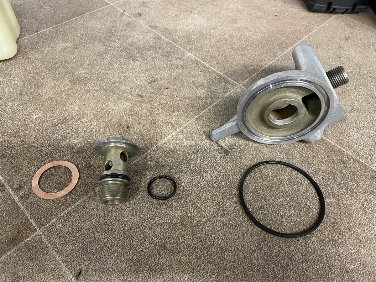

Lying under the vehicle, it's impossible to take a picture, so I'll try to explain it another way.
In this first photo, you can see the oil filter adapter.

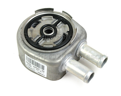

In the second photo, you can see the cooler that attaches to the adapter.

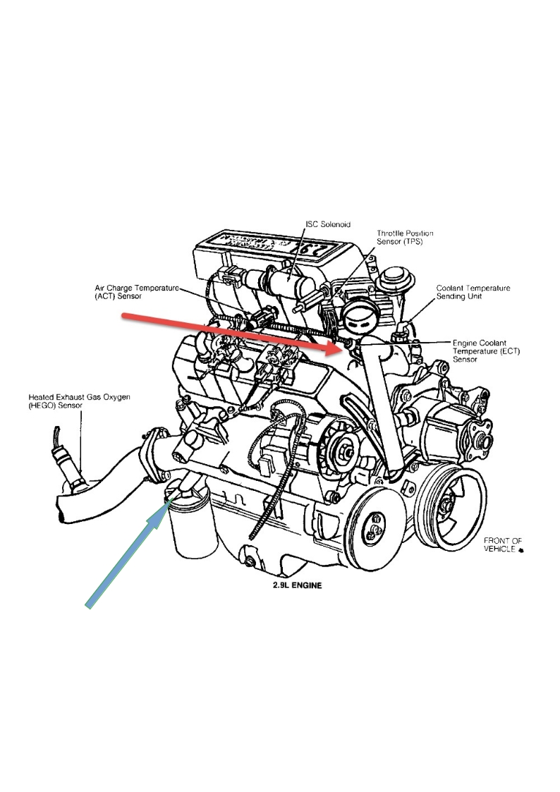

and on the diagram you can see where it connects, where the blue arrow is.

The second pic looks like the filter relocating kit i had to use my 88 when we V8 swapped it back in the 90s. Hopefully someone smarter than me chimes in though haha

From what I remember, one hose goes to the water pump and the other goes up to the heater core behind the glove box.
So to bypass you'd just route a hose directly between the heater core and water pump.

That is indeed a engine coolant cooled style of engine oil cooler. Like previously mentioned, the cooler can be capped off with some rubber caps. As far as the hoses that connect to it, they will need to be connected to each other some how if you really want to eliminate the cooler from the system.
From what you are describing, it might be better and easier to just restore it back to how it was. Looking at the pictures, it looks like the cooler is attached to the block via a threaded tube that runs through the middle of the cooler, which also provides something for the oil filter to thread on to. Look for a hexagonal flange on the tube with the oil filter off. That would be how you can loosen it to rotate it or remove it so you can get the hose back on.

Looks like you can just remove the cooler entirely. The 1st picture that shows the disassembled parts is the stock right angle adapter that is on all 2.8, 2.9, and 4.0 engines. You need that so that the oil filter is oriented correctly to clear the frame. (I took that picture so I'm intimately familiar with it ;))
