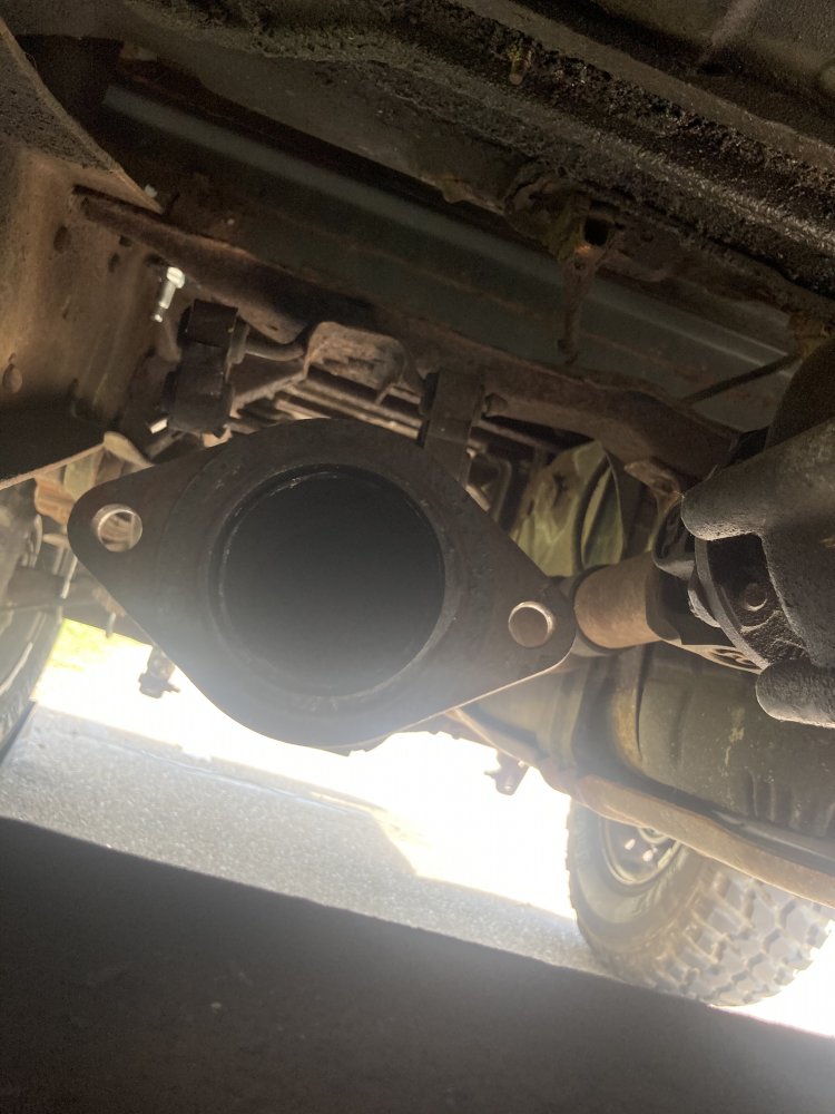

Here’s the output of my old cat ..
60080

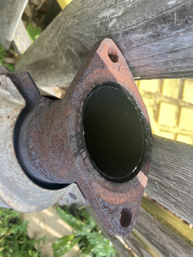

here’s the input of my Intermediary Pipe, made by Walker which I put in last fall and which looked the same as what I took off..
60081
obviously those two ends above mate up perfectly with the flat gasket as illustrated here..
60082

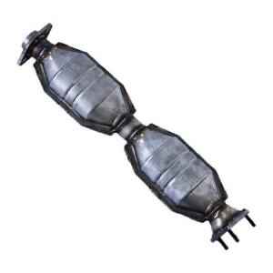

But, the BRExhaust I bought from rock auto has this kind of output(I forgot to take a pic of the actual exhaust but this is exactly what it looks like..)
60083
not surprisingly, I found that image by searching for 1990 not 1989. But this is what the BRExhaust 0643095 from rock auto looks like upon arrival .. https://www.rockauto.com/en/catalog...2,exhaust+&+emission,catalytic+converter,5808
sadly the other end isn’t pictured on website or this wouldn’t have happened because I would have seen it.

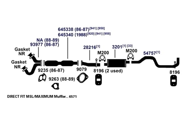

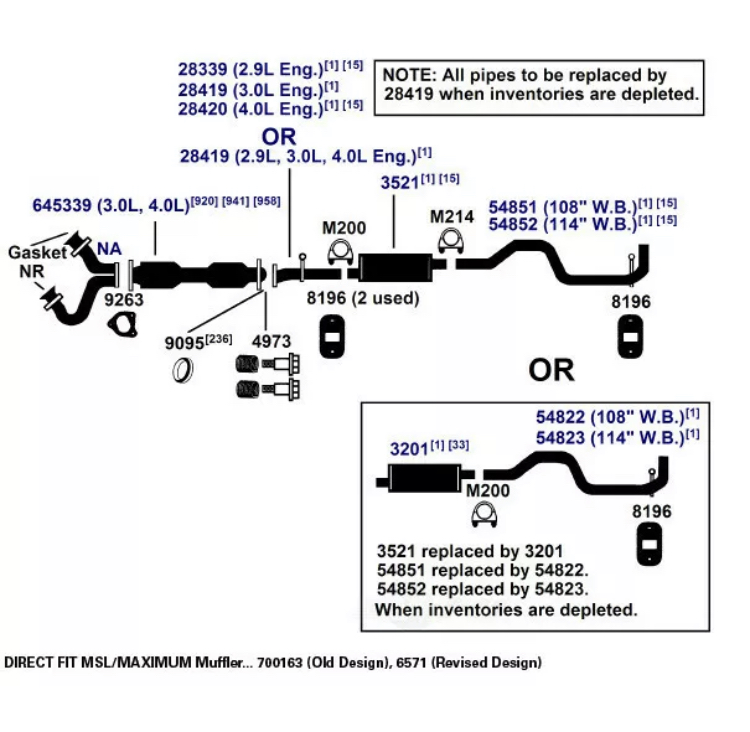

but I found this diagram that shows it’s system..
60084

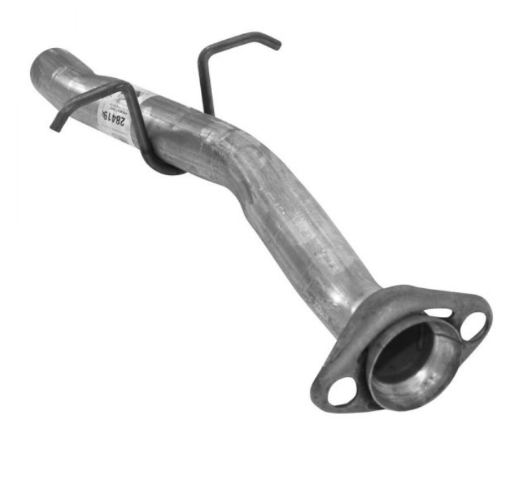

so, I think the easiest solution is to see if this intermediary pipe will work for my truck since it clearly is designed to mate with the new catalytic, but my concerns are about fitment / hanging downstream..
https://www.carid.com/ap-exhaust-technologies/exhaust-pipe-connector-mpn-28419.html
60085

I will order the intermediary pipe for 90-92, which has the correct connection to output of cats, and hope to just get lucky that it lines up decently enough with the muffler and tailpipe. I can create hang points if needed, and don't care too much if output of tailpipe is off from OEM by some inches.
