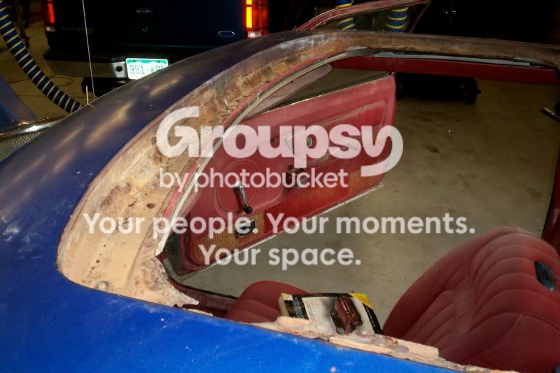

so as some of you kno i bought a 79 mustang. well after ive had 3 people that want the car....they have fell through. after i get my pile of crap chebbie running im going to be in the market for a muscle car. i still have the stang and it hasnt sold. so im kinda thinkin of fixing the sunroof thats rusted through. after that if it doesnt sell i mite build it for myself. my question is; how should i go about repairing the roof. (pics below)
i had the sunroof laying on the roof made a run to the parts store;came back and it was gone:annoyed:. so i have a tarp over it but id like to repair the roof. it would make it easyer to sell:icon_thumby:
i was thinking of takeing a pice sheet metal and welding it over the hole.
You can do that...
but it will be pretty tough to get the panel curved with your roof so it matches and doesn't look silly.
I would find a roof from the same car that does not have a sunroof (they exist) and then cut your roof off at the pillars and weld on the new roof at the top of the pillars. This will be the easiest way, with minimal welding/grinding/bondo-ing

If you want the sun roof, I would sandblast the rust, and then repair wherever it is rusted through, and then put in another sunroof and make sure to seal it well.

id like to just get rid of the sunroof all together.

If your looking to eliminate it, getting a whole new roof is the easier option. You merely cut the pillars and weld on the new roof.

You can try welding a piece of sheetmetal over the hole, but I'm telling you right now if you have never done extensive body work, your in for treat. Making it match the rest of the roof will be a pain!!! I promise.

thats what i was thinkin, just get a new roof. but thats not a easy task finding a donor. in the past 4 months ive seen 2 mustangs of the same year at the yard and they were both convertables. they were only there a week

If you can find another roof definetly go for the pillar cut option, but if you can't then try to find another sunroof frame and weld it in.

No offense to Paleblue, but I doubt it will come out perfect if you haven't done it before and have no training on how to do it. It very well might be worth more now with a junkyard sunroof in the trunk as a project car than if someone used it as a learner car on how to swap a roof.
