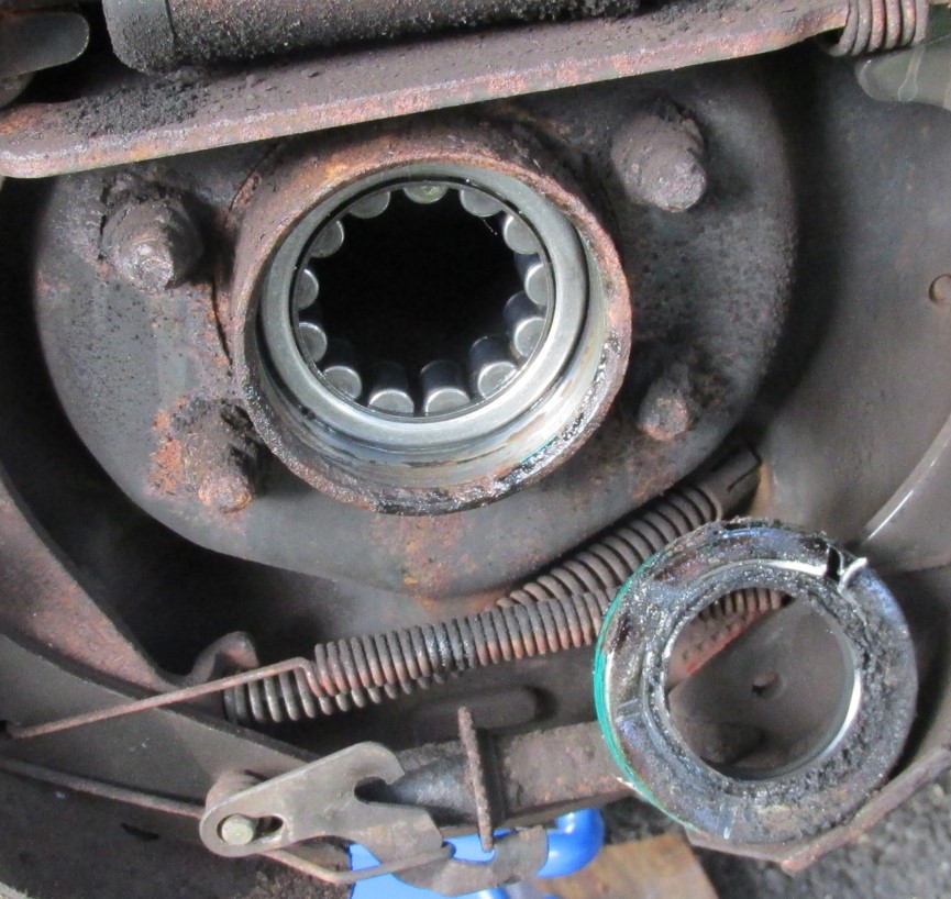

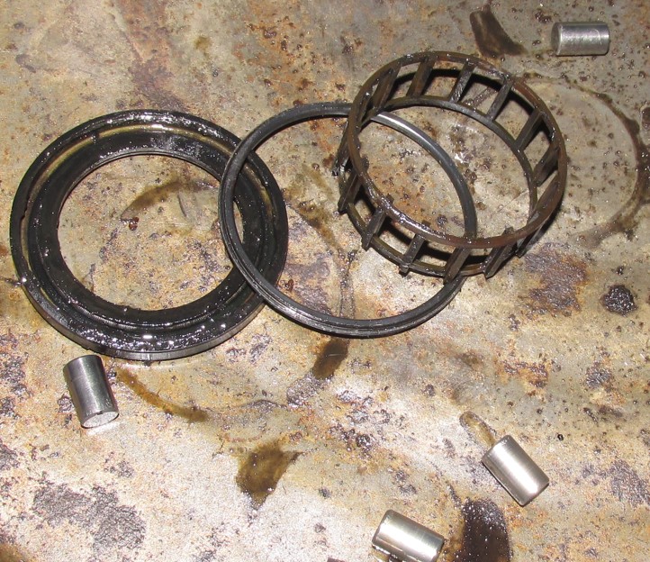

With one rear axle seal leaking I prepared to replace both. Upon disassembly I noticed what you see in the pictures below. I'm assuming this is a repair bearing for a previously spun bearing race. It doesn't look like a sleeve, as best I can tell this is one piece and serves as an outer race. The first picture is what looks like a factory bearing & seal of the right axle. Second is the repair race/sleeve with the inner spring retainer for the bearing still in place for the left axle. Further inside the axle is a single lip seal. Third picture is a shallow V-seal, bearing outer spring retainer and cage (from L to R). Unfortunately I couldn't simply attempt to ID and source a proper seal because upon inspection I found that bearing failing with flaking and pits evident on the rollers.
The previous owner (92yo family friend who bought truck new) doesn't recall any repair work having been performed on the rear axle bearing. With excess RTV on the paper gasket evident I'm confident someone was in there. Any insight and/or recommendations provided would be greatly appreciated.

Not sure if I'm reading your reply incorrectly but I should clarify my OP (which I've also edited). The 1st picture is of the expected OE installed bearing and seal which I found on the right axle. The second and third pictures are of the non-OE bearing and seal which I have to assume is a repair. As you eluded to, I've found nothing on this forum or elsewhere pertaining to spun outer races on a Ranger (or equivalent Fords). Not knowing anything about this particular install I'm not sure if it's simply press fit and also whether or not any machining was performed on the housing to size it proper for the insert. Pretty sure the bearing isn't going to be an off-the-shelf item.
The more I think about it this could be nothing more than an axle repair bearing. I had put that thought aside as I didn't see any wear on the axle itself which is what my understanding those are for, simply moving the V-seal contact location. I'll just give the outer race a tug or two tomorrow and if that is what it is it should come out relatively easily. If I see no wear or gauling on the housing we can be pretty sure that is what's likely.

Those offset bearings used to be a cheap fix for a bearing failure that scored up the axle back in the Fairmont days. A new axle and a stock bearing are a better way to fix it.
Appreciate the insight RonD and 19Walt93!
If I recall the axle looked to be blemish free at the bearing and seal contact locations, hence the reason my imagination took over in the OP. A closer inspection tomorrow will guide the repair toward a simple bearing/seal replacement or one of your suggested options.
