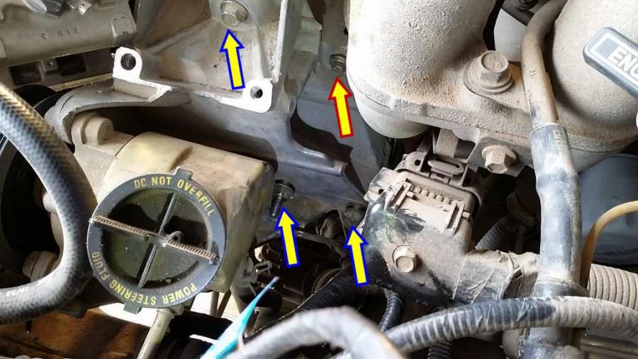

The next thing I encountered was that the power steering bracket has four mounting bolts not 3, and one of them serves as a retainer for cabling. The three blue/yellow arrows are take a 13mm socket, the red/yellow takes a 10mm socket.

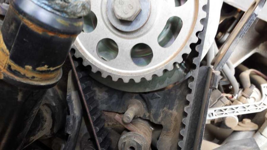

Once I got the cover off, I noticed the timing was off. The belt did have some surface cracking, but all the teeth were in good shape. It may have stretched some, but I think the timing was set wrong the last time it was done.

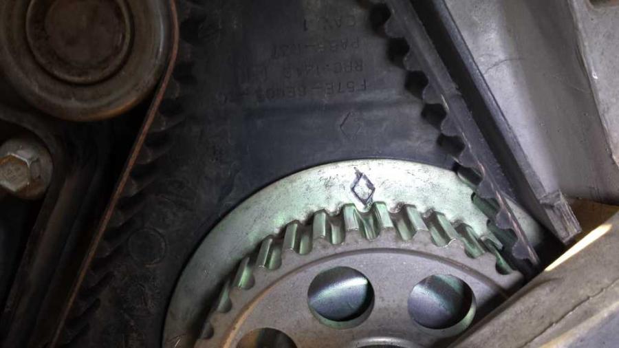

The reason I think that is because when I first set it with the new belt and the tensioner snugged up, I noticed both sprocket rotated CCW off their marks. I used the method suggested where you start from the crank and work your way CCW. Trying this twice still didn't produce the desired results, so instead I lined up the crank and the oil pump first, then routed around the tension and one side of the crank sprocket.
While a helper used a bar to relieve tension from the tensioner, I was able to guide the teeth onto the cam sprocket and keep it aligned. Triangle to triangle on the cam & diamond to diamond on the oil pump. Remember that both sprockets have identical markings - so don't confuse triangle with diamond on either one. If you have to lay the bar against the oil pump sprocket, be sure to use a section of the old belt to protect the teeth.
Also, don't forget to tighten the tensioner after you've rotated the crank pulley at least twice and checked the timing marks.
Cam

Oil Pump

I marked the triangle & diamond for each with a black marker, This made it easier to see with my mirror once the cover was back on.
