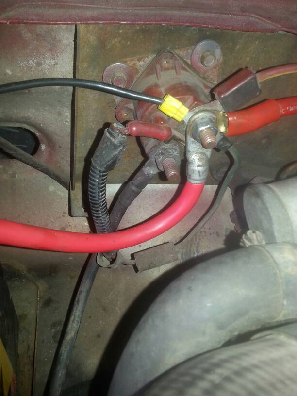

Yes that's true. The "battery" side meaning the one that is wired to the + battery terminal has multiple wires. And I had tried those ones too. The only one that seemed to "crackle" was one that joins the smaller wire (with the little rubber boot thing) on the small threaded terminal they join in a bundle below. If the image works, it's the greenish one at 4 o clock. Both seem like they snake around the front to the bigger bundles on the drivers side fender. But I don't understand, if the starter was good, shouldn't it have turned over when I touched its wire to the + battery terminal?

One thing for certain...the big red wire on the top is way too close to the black wire. They can arc out very easily. You should remove the big red one and bend it so that the connector faces away from the bottom wire. There is a little bridge between the two posts and that is there for a reason...so you don't get the wires too close.
The little red boot is your ignition key start line...when the key is in the run "start" position that wire is activated and it closes the relay (also known by many as the solenoid). If that wire is corroded you will get nothing when you turn the key...or if that post is internally broken you will also get nothing and need to replace the solenoid/relay...
Your wiring may be contacting in other places...like the connectors on the starter. I've seen mine break off and dangle...meaning they could touch other wires or ground out on the motor...so check those also...
One big terminal should have only one wire going to it, the starter wire. That looks correct. The other big terminal should have all the other wires needing battery power, including the big wire from the battery. That looks correct. However, I can't tell if the ignition key start line is connected to ONLY the small terminal, it looks like it also connects to the battery+ terminal, which I believe would be incorrect.
Yes, that certainly does look like the starter line with the boot circles around to the other side with a fusible link in between...my gosh...that is definitely not right...it may be two wires coming close to each other though...some on the older models run behind the panels and whatnot...but...mine had a plate and plastic cover over that section and all wires came from under it...
I would still move the big red cable over a few inches...and if that green/red wire with the boot is one wire...that needs to be corrected...should come from the harness on the driver side with lights, windshiield washer fluid pump, horn, and passenger ejector seat...:icon_twisted:
The wire around 4 o'clock is another fusible link wire feeding power from the battery to ???
The wire around 10-ish is the starter relay power source. When the key is in START, that wire should have power, thus powering the relay coils. Coils powered will pull the core into the magnetic field, and pull a copper bar along, too. The bar will connect the big fat battery cable post on the right, having power, to the big fat starter cable post on the left, sending it on to the starter motor, hopefully cranking the engine over.
You can connect the small post, GENERALLY, to the fat battery 'side' post, and enable the relay.
If you jumper from the BATTERY post to the small post, the relay should click or snap. It should also send power to the starter motor, so don't have the transmission in gear.
The starter draws a lot of current. It will actually make the fat wires jump when the power goes through. They'll move, because they set up a field.
If you use jumper cable size wire & clamps from the battery side to the starter side, there'll be a LARGE spark or 12, and the motor should crank. It will make you jump. Don't dither, connect good and hard to minimize sparking. Be ready to disconnect if the motor is locked as you'll get hot cables quickly. If that works, you may have a bad relay.
I would test for 12v coming from the ignition switch when the key is in START at the small relay wire. A screw jammed into the connector along with wire connected to a grounded bulb should show a lit bulb when START is selected.
