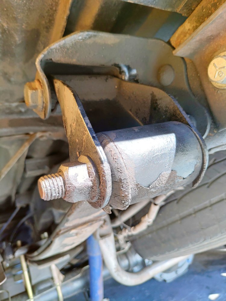

I've been driving the truck today and everything seems fine. I did not have to remove the truck box or frame-mounted hangers. The only leaf spring hardware I re-used was two flag nuts. Everything else came from the shackle kits and Ace Hardware.
I notice some paint has already flaked off the leaf springs. This probably happened during shipping. I don't spray undercoating directly on leaf springs........do I?
Just touch-up with black spray paint ?
The ranger leaf springs have different sizes for the eye hole. At least mine does.
Couldn’t put it in backwards, bolts would not fit.
older models may have varied
Ok.Thanks for commenting on that. I was wondering about the reverse fitment of these new springs.
