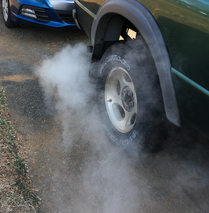

picture of exhaust
That kinda looks normal to me... considering the temps... and the fact that water vapor is always present in the exhaust stream. It should lessen when the engine gets to operating temp. I just remote started my truck... it's -10 right now. She's steaming pretty good.
