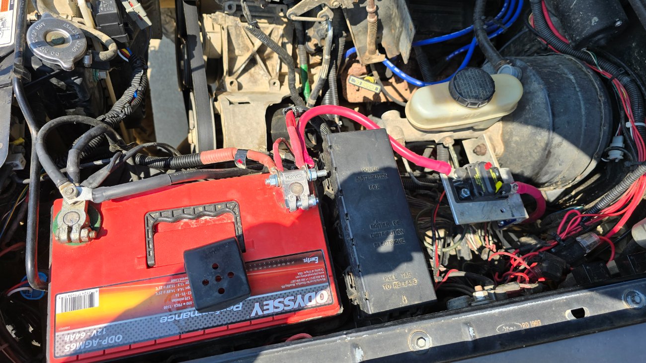

if when I need to replace those, are there special clamps I can buy, as the negative has three wires and positive has two wires. Thanks

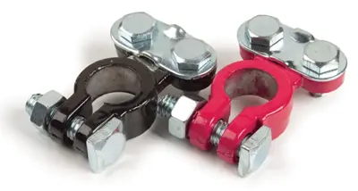

I would strongly recommend that you do NOT use the repair clamps where you put the cable ends under straps. These do not work well. They come loose and also seem to allow corrosion to develop easier. They are garbage. See 2nd image below.

Please, for your own sanity and for reliabilty, avoid these at all cost.

There is a way to use the ones Eric showed at the bottom in a not bad way but it is not as designed... on my '97 or was it my '00 Explorer... don't remember but I took the broken sheet metal clamp and cut the extra off and took the bolt and put it through one of the bolt holes... it was the easiest thing I could come up with and has been dead reliable... but yes other than that I would do as in the top picture and use the marine adapters and ring terminals or multi piece cables.
