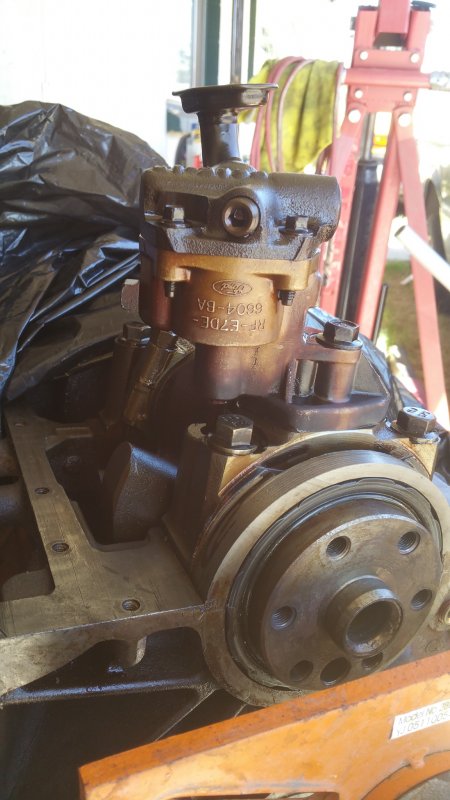

Just wondering since I have the engine out. How vital is it to change the oil pump? I have a leak on the pan gasket which I'll change. I really need the $100 for other parts but could scrape something together if really needed.

Dirtman… is a funny guy. I believe his comment was an attempt to be funny. When the oil pan comes off... inspect the oil pump. You should find specs in the service manual. If it looks questionable at all... replace it. Now is the time not after it is put together and running. I would also take into consideration what the oil pressure was before removal.
Most oil pumps, my experience, are good for far more than 115,000 miles. Just be sure it is clean with no varnish build up.

Just for my education, who would replace this oil pump? I've had no oil issues and the screen is clean. But it does appear someone burnt the oil at one time maybe.
Take it apart and measure the clearances. Look for scoring on the flat surfaces. Don't stretch the spring.
Took your advice and the gears measure and look good. Very solid unit. It's a keeper.
