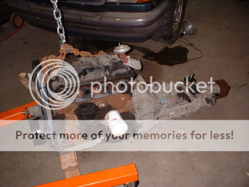

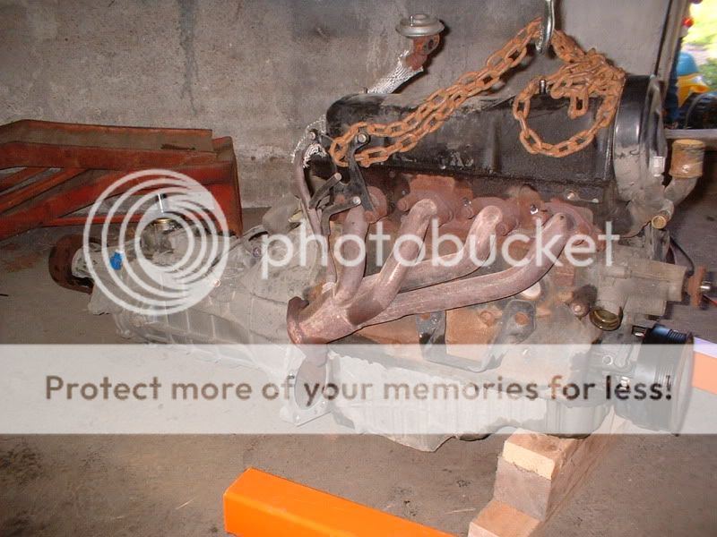

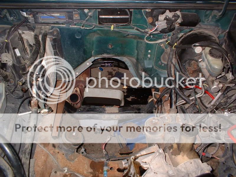

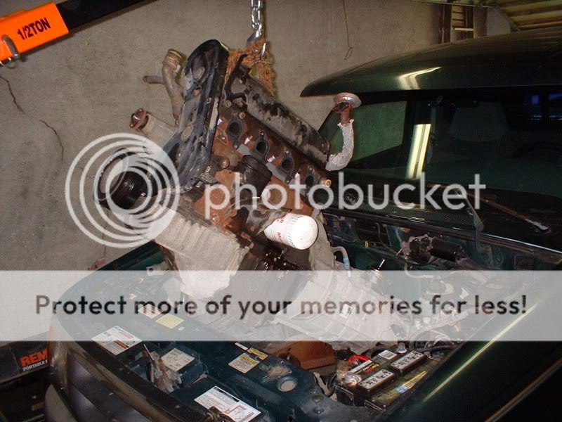

Ok, I tried it with the trans still on the engine and all went well. I couldn't get the bolts out of the transmission cross member because they were rusted in the sleeves, but I managed to get it pulled even with the cross member still in place.

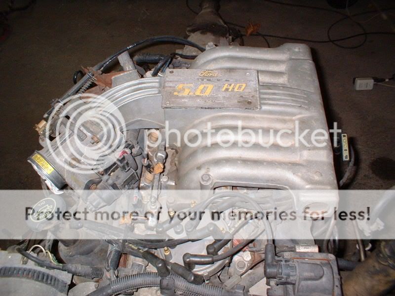

Here are a few pics of today's work and 1 pic of the replacement engine...
It CAN be done!
