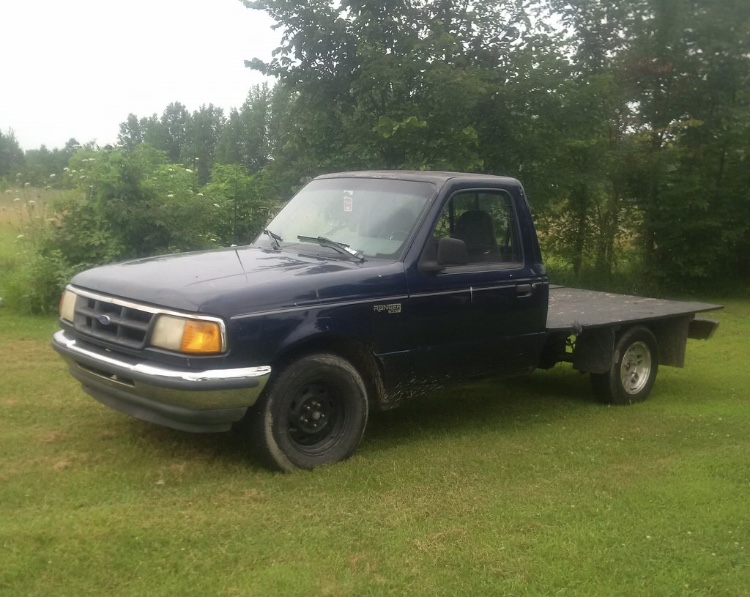

Might be easy enough to bolt a sheet of plywood over the frame, with some 2x4 to raise it up. Can attach you lights to that, and you technically still have a bed.

Ive made a cheap plywood flatbed for a temporary situation between bed replacements. Boat trailer lights plugged into the trailer plug, mud flaps. easy-peasy.
Yes, just mount LED trailer lights to a 2x4, make sure your license plate is lit, and get the small 3/4" white lights from Northern Tools for reverse lamps. I like the previous post with plywood and mudflaps.

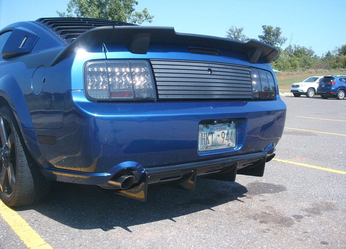

There are so many rat rods running around Oklahoma with open tires and nothing covering them. No fenders, mud flaps, nothing. And what about cars like my Mustang, where the tires already stick out past the fender when they leave the dealer? Granted, they're 255's versus the stock 235. But they are no further in or out than the stock tires were. They protrude well past the fenders from the tire half way point down. Nothing has ever been said to me about my Lightning with the 12 inch rear rims and 345 M & H tires. Nothing has ever been said to me about the tinted license covers on all my vehicles, nor the lack of a license plate light on both my motorcycles.
