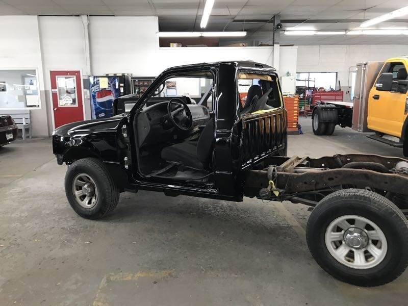

I'm thinking of using the frame I built to pull the engine to lift the bed

Hope that's primer, RED Rangers are the best :)

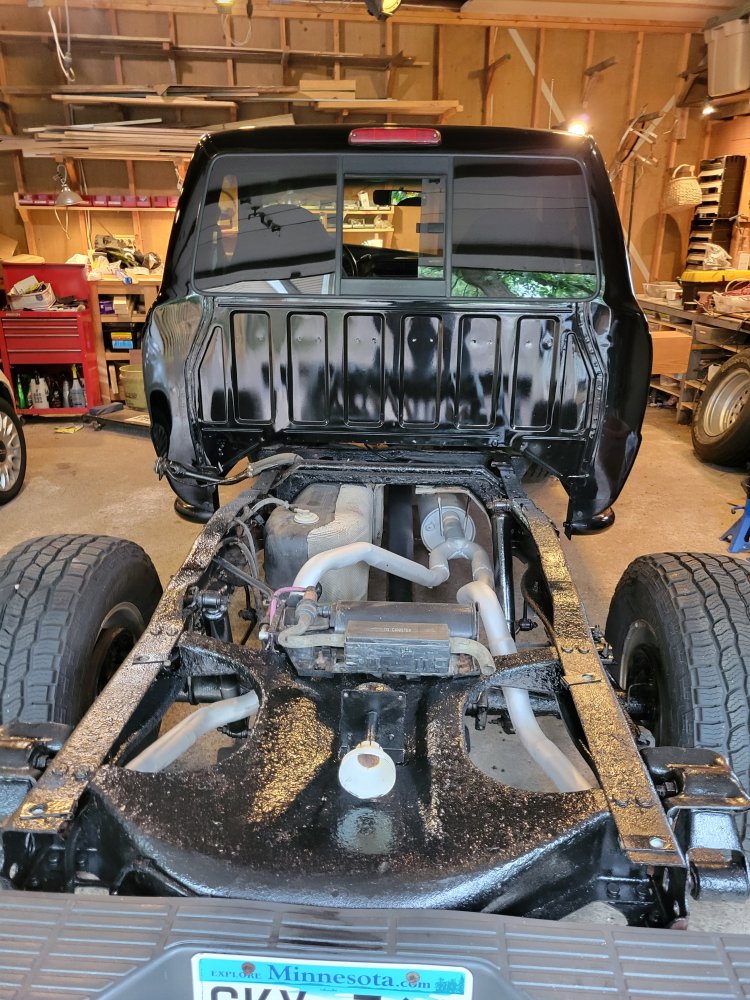

This was just the first time I took the bed off and took a good hard look at the rust. I sand blasted the rough stuff off then coated the frame and the bottom side of the bed with POR15. This was an which rides rather high, so I lowered the back end by one inch. I've also painted the exhaust system with Rustoleum exhaust paint. I've had good luck with this product. It still looks good after a winter.
