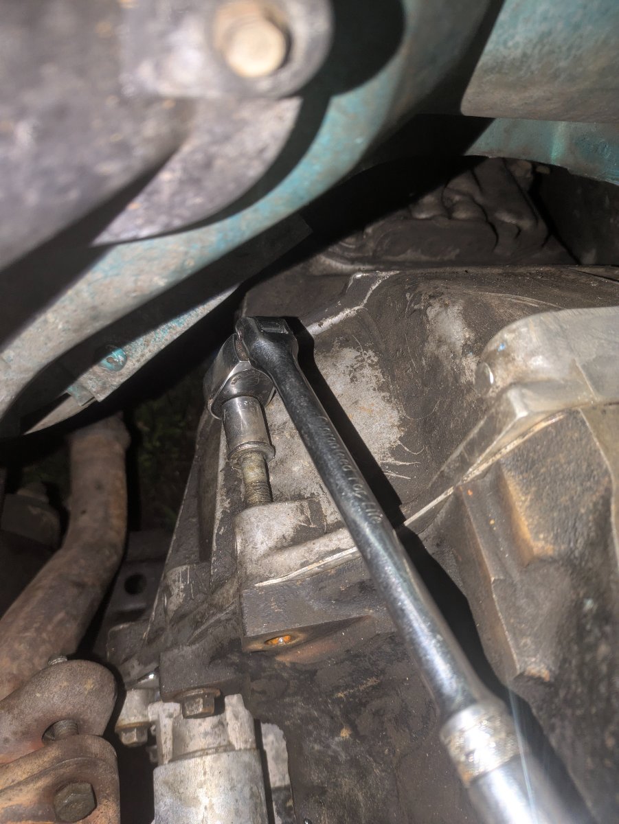

I'm probably the only person still fighting with a 94 mf 2.3L twin spark blah blah blah but just in case someone may need this
  • Removing 2 top Transmission bolts ??
been there, done that, a swivel head ratcheting wrench is easier but yeah that works... Now that I have more tools I use a really long extension or two and a swivel socket and do it from behind the transmission. First time I did the clutch on my '90 (ok, probably first two times) I didn't have a transmission jack, I think the first time I just muscled the thing in but I was young then...
