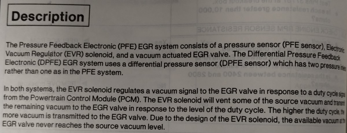

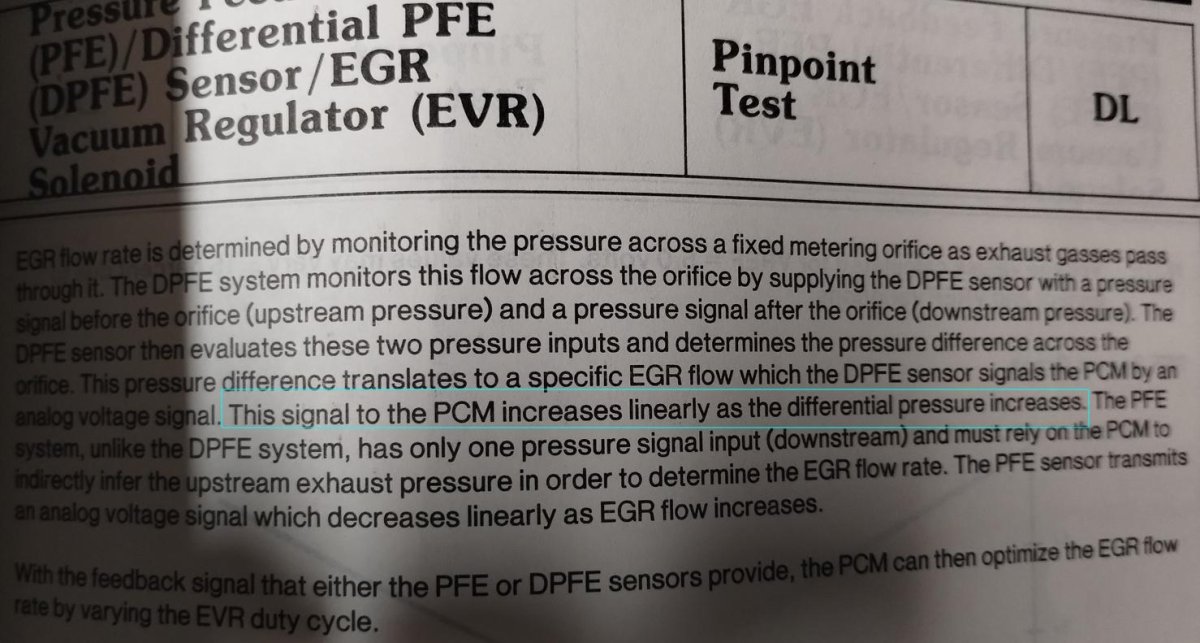

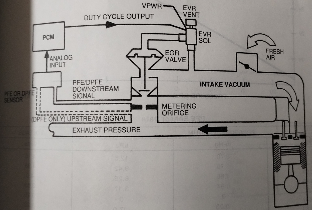

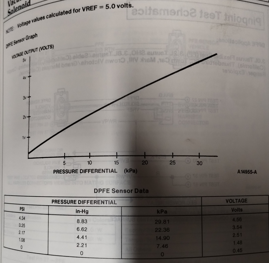

  • Bypass DPFE. I've thought about this before, and it actually seems plausible conceptually: tap the computer output to the solenoid, convert from PWM to analog, adjust to the expected 0.7-5.0 output range, and send it back to the computer. Downsides are that I don't know enough EE to pull that circuit out of my ass, I would need to build out the same wiring anyway, and I might end up with knock.

I have thought about this before. I was thinking of putting a 12v bosch type 5 terminal relay on the same wires for the EGR solenoid. Let the computer activate the relay instead of the solenoid. When the computer activates the original solenoid, which sends vacuum to the original EGR, it expects a certain voltage level from the DPFE. So take the original DPFE wires, hook them through the new relay with resistors. When the relay was activated, it would put a resistor on the DPFE circuit and make the computer think it was really doing something, when it really isn't.
Assuming 12v is correct for the duty cycle signal, and the computer would be happy enough with two discrete values "EGR on" and "EGR off", rather than insisting on a smooth curve, that would be fairly simple. I think you want it the other way around, though: DPFE return voltage should increase proportional to flow, so it's going to expect 0.7V (resistors) at no EGR, and 5.0V (reference) at wide-open-EGR.
Pardon the shadows:
Really, I need to build out the solenoid wiring and figure out exactly what the duty cycle signal looks like, possibly the actual DPFE voltage that results under different conditions as well. Then test a simple bypass, see if you avoid the CEL, and if not, make it more accurate.
