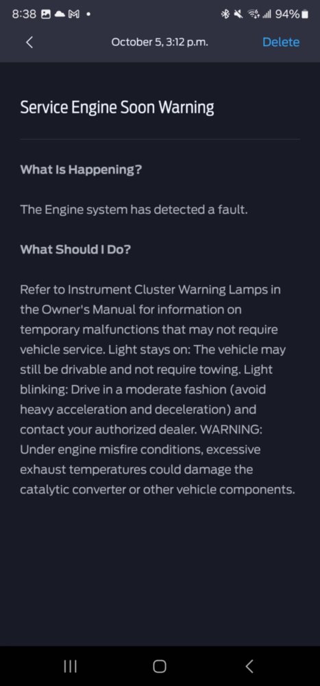

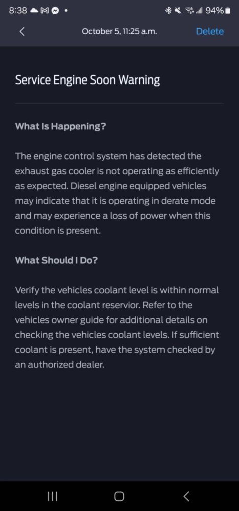

*ANOTHER UPDATE* Pre-Service appointment, I've put over 2000 km on since the transmission was "replaced" in the last 500km or so Its popped a transmission light and started giving my Ford App all kinds of notes. Can't wait bring this in for fixin and actually start enjoying this fantastic truck.
