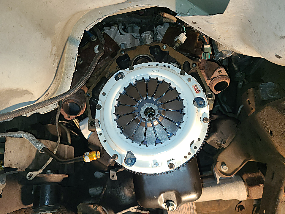

The weather was nice today, and I was able to seal and torque the flywheel bolts, as well as clean and install the new clutch.

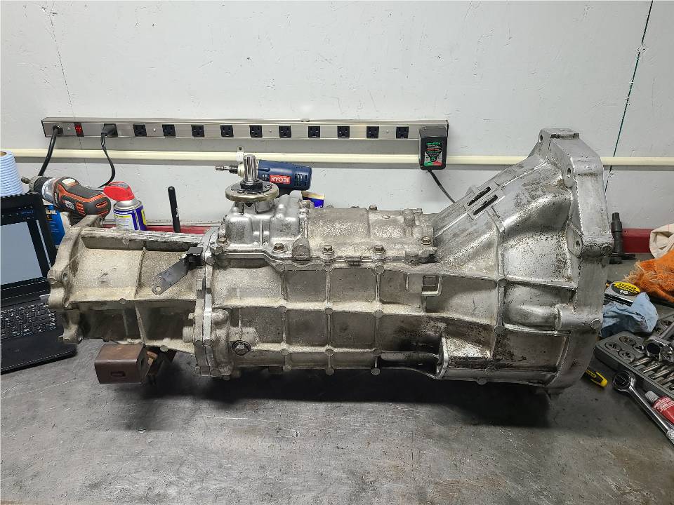

In other news, the transmission is now fully assembled and ready to be reinstalled!

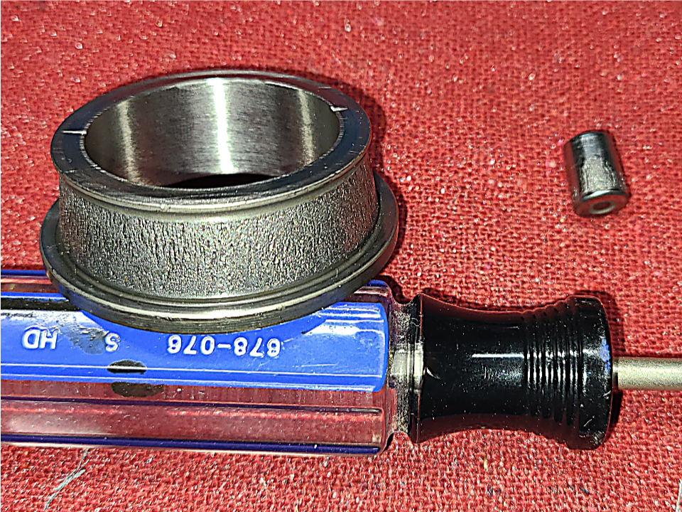

I don't think I shared this yet, so here's a picture of the inner bearing race that was responsible for all the noise:
