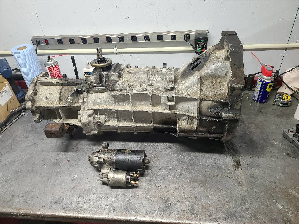

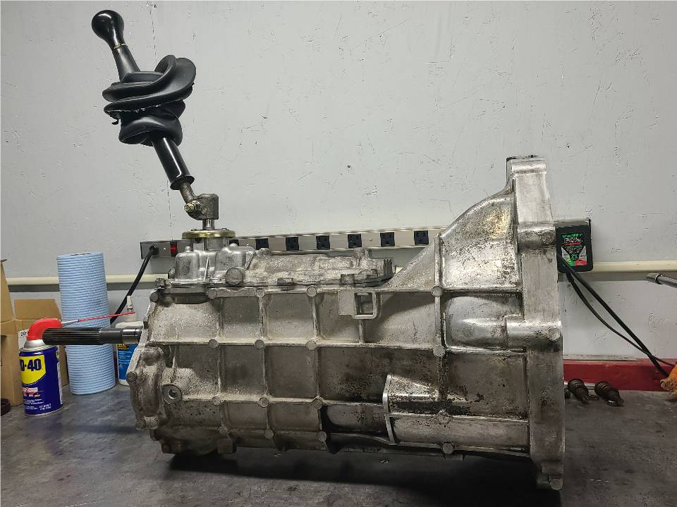

It's finally out and on my workbench!

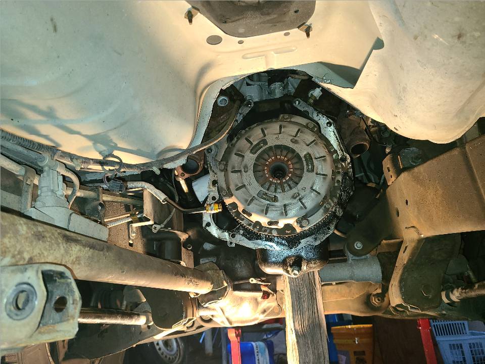

There was a 6th bolt hidden behind the bell housing. So four bolts thread into the engine, and two thread into the bell housing. After that, the transmission slid right out. Lowering was fine, but my transmission jack didn't reach all the way up to the transmission, so I used wood blocks to make up the extra height. Then the jack didn't lower far enough to get the transmission out from under the truck, so I had to wrestle it onto the creeper I've been using. My son helped me get it onto the workbench.
There's a lot of black goo inside the bell housing. My mechanic says the slave clutch cylinder has been leaking. I'm guessing that's what it is? I rarely have to add oil to the engine, and as far as I know, the transmission doesn't leak. I'm planning to replace the slave cylinder anyway.
The clutch looks clean and dry to me.

The outside has been cleaned up, and I've drained the ATF. The magnetic drain plug has a lot of swarf on it. I had the fluid changed a couple years ago when the noise started getting bad. I'm assuming the mechanic cleaned off the plug before reinstalling, so maybe that's bearing material.
I've noticed that there is a bit of slop in the input shaft side to side. There's none on the output shaft. I'm going to review the info I've found on disassembling this thing tonight and start taking things apart tomorrow.

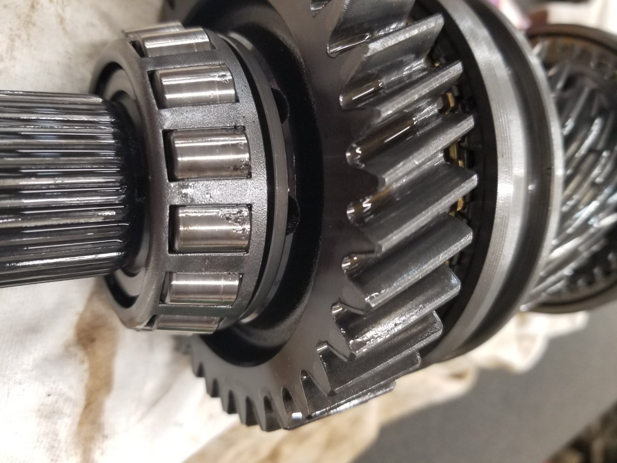

Here's some pictures of what I found on mine, that inner bearing race was SHOT, was sharp like a file... also had a pocket bearing that lost parts of the supports between the rollers. I also threw in a picture of the puller setup I had to use, the puller is just an old Proto I borrowed (since found one at a garage sale so I have my own), it already had holes on the sides of the hooks so I just made simple extensions with scrap I found... that bearing isn't super tight but needed help to remove and you have to pull it to get it apart... Oh, the dumb trick to get the big nut that holds that bearing on off is to first un stake it then move the gear selectors into two gears at the same time which binds it up...

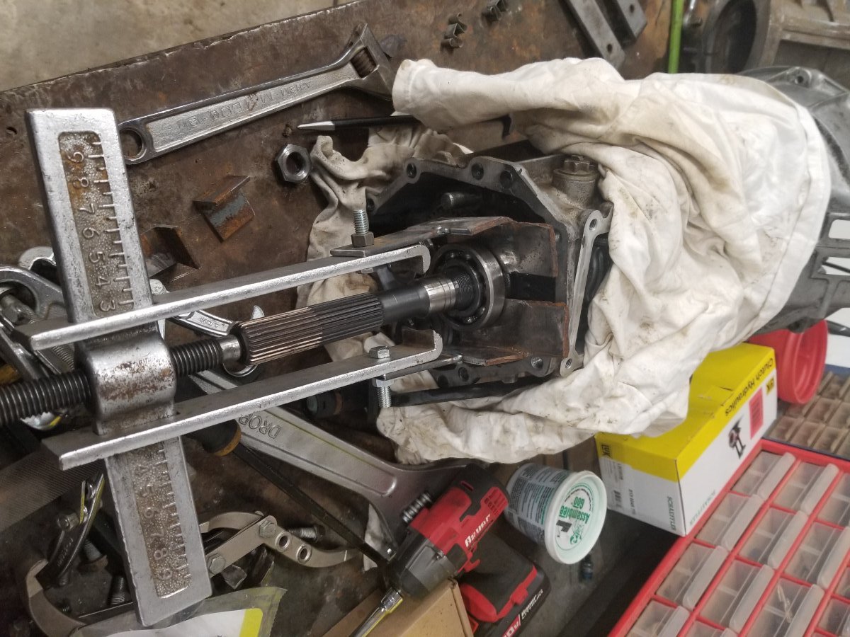

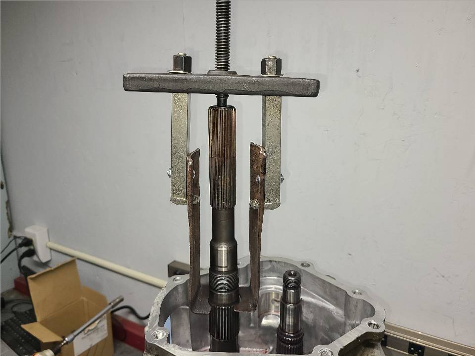

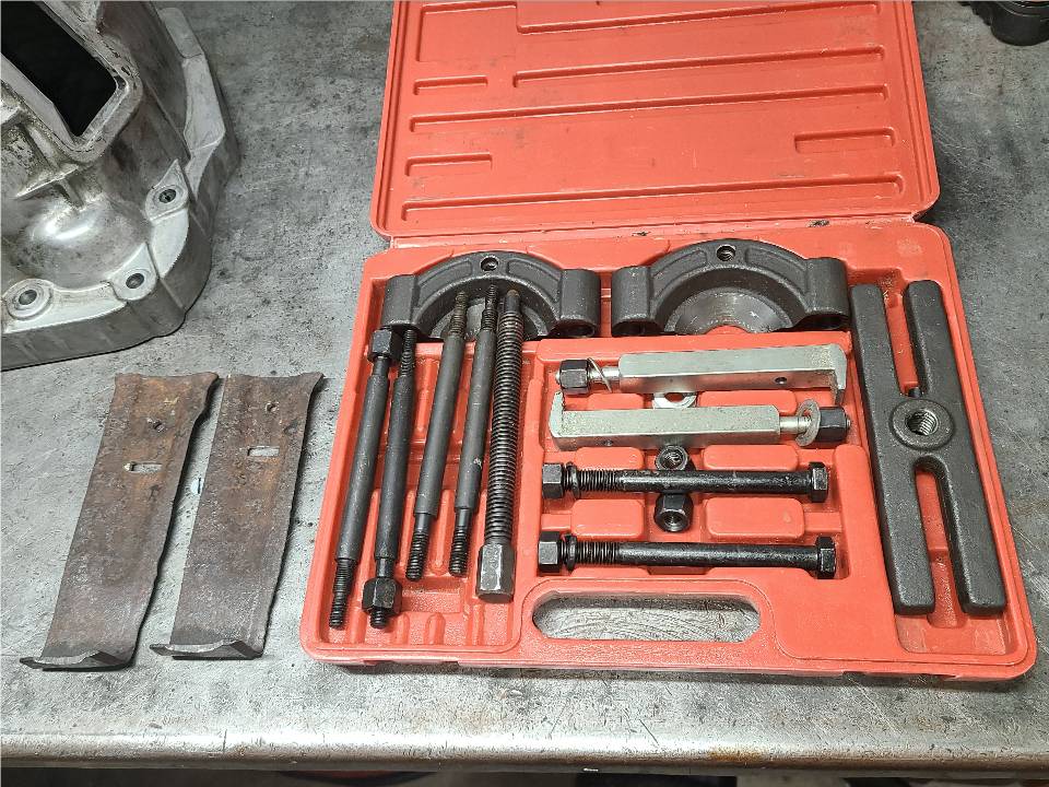

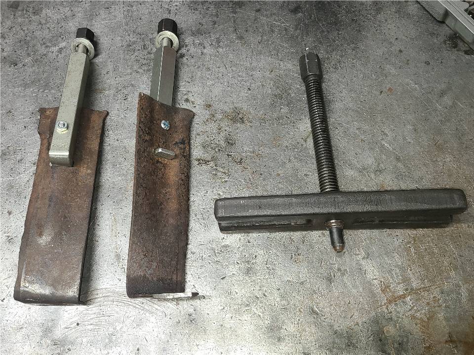

So for the puller, how long do those arms need to be?
I went through my scrap pile and found a couple pieces of lawn mower blade. I heated them up and then beat the daylights out of them until they were flat with a 90 degree bend at the ends. I ground a hollow in each end to fit the shaft better, and did some grinding, filing, and drilling to attach them to an existing puller I have. I didn't do any measuring; I just eyeballed it. Surprisingly, it worked the first time. Nothing broke, and the bearing is out. I forgot to take pictures of the tool mod. I'll do that tomorrow if I remember.

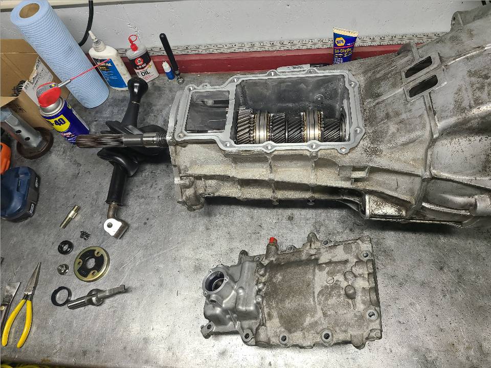

Today I got the back end disassembled.
Rebuilding my M5OD-R1 99 Ford Ranger Transmission
There is supposed to be a ball bearing somewhere on the countershaft that I forgot to look for. I'll see if I can find that tomorrow. I didn't see it on the part I removed, so hopefully it's still sticking to the shaft. Everything is coming apart nicely so far.

Perfect, like I said it's not a hard pull just needs to be deeper :), what I made was just mild steel and held up fine, I've since bent them doing other things they didn't like I think rebuilding the ZF5... I'll straighten them when it comes to it again...
The bearing on mine that was screwed is the one in the middle of the output shaft between I think 3rd and 5th...

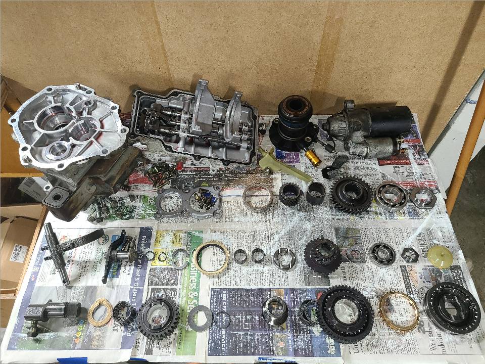

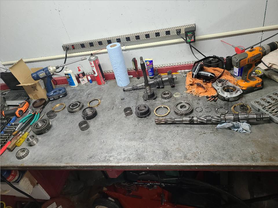

Got the rest of the transmission apart today:

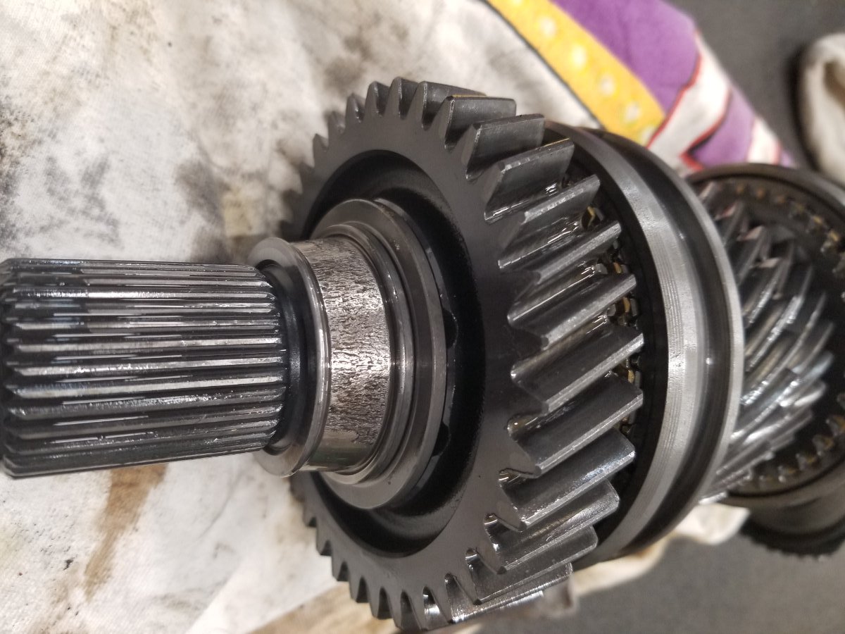

As far as I can tell, the only worn part is the tapered bearing on the end of the output shaft. It looks similar to Scott's. I wonder why it only makes noise in 5th and 3rd? I also didn't find any missing parts that could account for the two bits of metal I found. There's no excessive play anywhere, and it looks like all the places that should have gaps do have them.

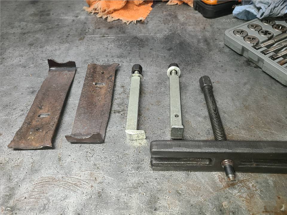

If anyone is interested, I took a few pictures of my pulling tool extensions:
A while back, I cut an old lawnmower blade in three to use the center bit as a flywheel puller. I still had the other two pieces in my scrap pile.
I heated them up red-hot and beat the daylights out of them until they were flat with hooks on the end. I ground some concavity into the hooks so they would wrap around the shaft better. I cut notches in them for the original hooks from the puller to fit into.
I drilled holes through both puller arms and the extensions to add a nut and bolt to each. Just to keep them from falling apart during use.
Like I said earlier, I didn't take any measurements. Just eyeballed it. Worked on the first try with just a ratchet turning it. I've never used these hooks from my puller kit because they're so fat they don't fit under anything. Now they may get some use.
That's the same symptoms mine had too. The reason you only hear the noise in those gears is they are the ones loading that particular bearing, 4th there's no real load on any bearings since there's no gears involved and 1 and 2 the output shaft is turning too slow and there's just less pressure on the bearing...
That make sense, thanks. I feel better now about not finding anything else wrong. There's really a lot I don't know about transmissions.

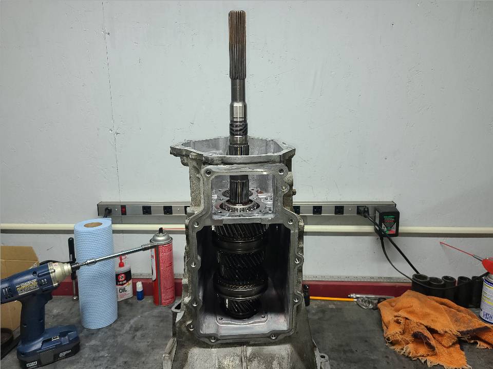

I discovered that my input shaft will come out the bell housing. Everything I've seen and read so far says it has to come out the top. I thought that was pretty cool.
