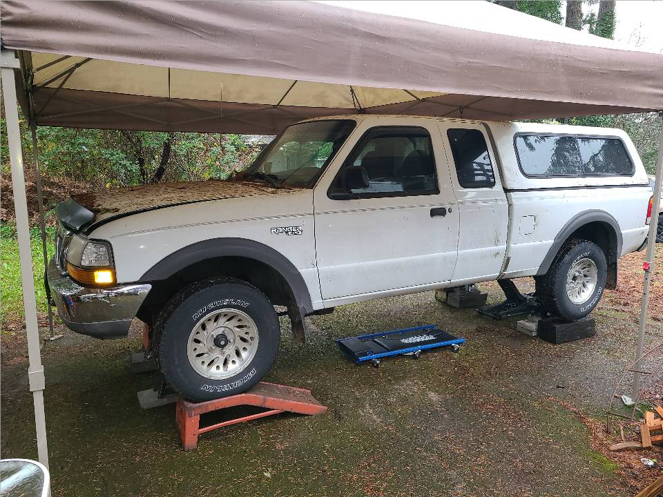

The truck is lifted up! Took me all day to get everything where I felt safe to be underneath.
Each corner has two ways to keep it from squishing me. Plus the 3 ton jack to support whatever I'm needing it for at the moment. I was able to get the drive shaft disconnected from the transfer case last night. Today I hope to get the transfer case removed. I found a video specifically on removing it:

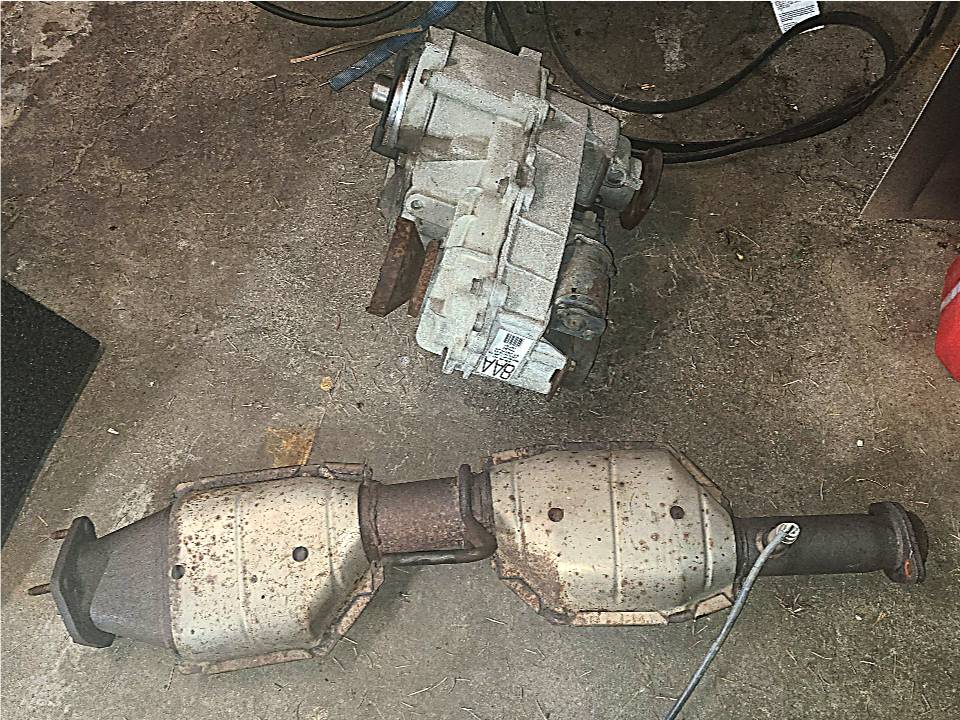

Well that's good, because I forgot to mark it again. The front drive shaft came off pretty easy. The top bolt securing the case to the transmission was the most difficult, but I eventually got it. Someone put red thread locker on the bolts. Anyway, the case came away from the transmission easy, and I lowered it with the transmission jack. Only one connector had to be disconnected for the electrical.
I was also able to get the starter motor off too. One of the three bolts was already loose. The other two didn't give me much trouble. I've been under the impression that the exhaust pipe needs to be out of the way to remove the transmission. I got what I think is the catalytic converter out today. The three nuts in the front were fine, but the two in the back were nearly impossible. I tried oil, a breaker bar, an impact driver, heat, a reciprocating saw, and finally a hammer and chisel. I won, but now I can't lift my right arm.

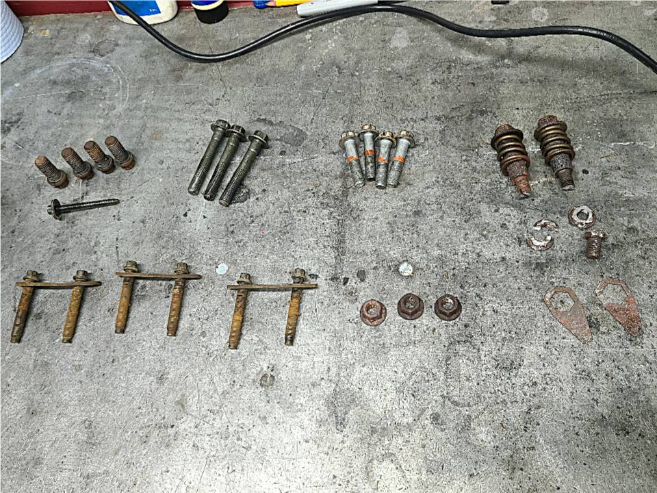

I'm getting a collection of fasteners now.
I can speak to your model but on an early 4.0 it's possible to pull the transmission with the y-pipe in place. Just barely. I cracked an O2 sensor doing it.
Since I already have the catalytic converter out, I went ahead and removed the y pipe too. It wasn't nearly as hard as the cat. I also cleaned up all the tools from under the truck to make room for the two jacks. I have the one positioned under the engine. Got the clutch hydraulic hose disconnected too.
