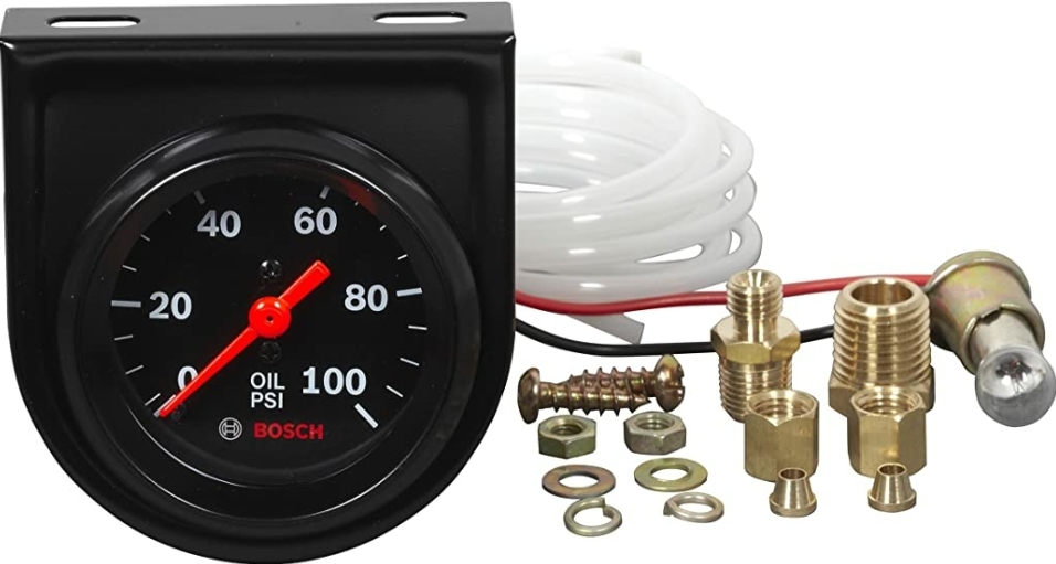

This is a capillary tube style:
do not get this

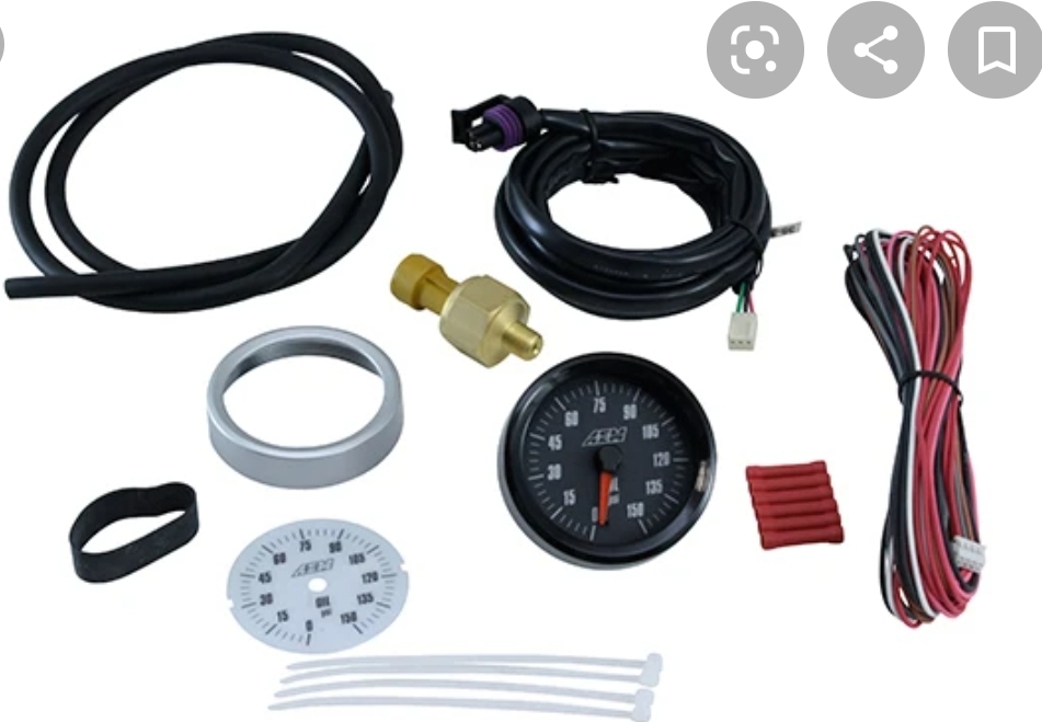

Instead
Get this
Much less likely to leak and destroy your engine.
