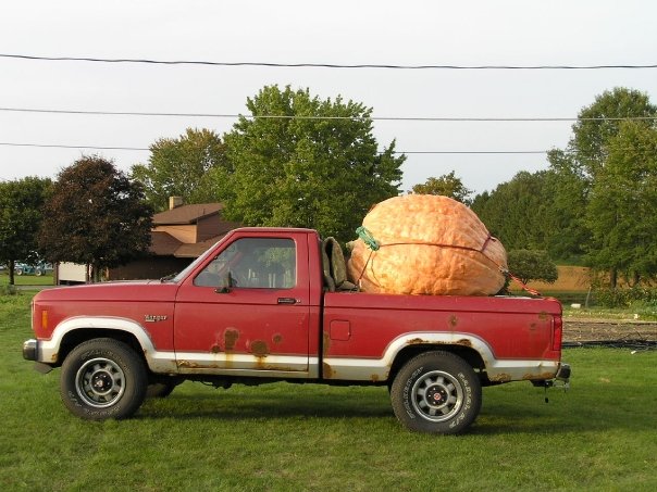

I have a 1988 Ranger short bed, 4WD, 2.3L 5 Speed with 98,000 original miles. At 75,000 my timing belt slipped, bent a valve and blew the head gasket. I had a valve job done and put it back together. The power did not return and I'm not sure if I did more damage than is apparent.
