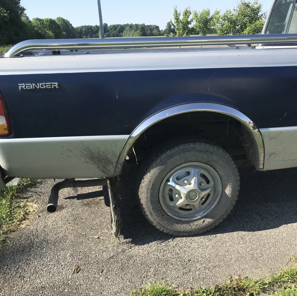

I am doing what I can to get this truck ready for my 15 year old daughter to start driving, when she is 16 in January.
It came to me with 31 inch x 10.5 inch tires. I replaced them with 30 inch x 9.5 inch tires.
If I hit a bump, I got the comforting sound of tires running on the fender wells.
What can I do? If I don't have to I don't want to cut and flare the fenders. Would I get anything out of changing the shackles? What should I get if so?

Can you do anything to help the rear springs? It looks a little low in the rear. My 84 Bronco II has a little rake to it like a pickup with the rear being a little bit higher than the front.
I was thinking that, too. The rear looks low. Springs may be worn out, bushings worn, brackets rusted/loose at frame.... you need to check it over real good and look for problems to fix before doing g modufications.
It’s not so much low in the back as it is high in the front. If those tires are 30” then there is a lift up there. Springs or leveling pucks but it’s lifted. Get some 2” blocks and u bolts for the rear to match.
Hour or two to install. Easy with basic hand tools a jack and some stands.

I put new leaf springs on. It's up an inch and a half in the front, Rough Country Leveler kit.
I replaced the leafs, I had an add a leaf kit on hand for it , but my mechanic, couldn't add the leaf. Taking the new springs apart was more difficult than he was prepared to handle, bushings were done.
I added Bilstein shocks front and back, just had the front end completely reworked and had to lose the front Bilstiens, the sold me shocks that were three inches to long.
I have heard, roll a bat on the fender well, using the tire and sort of bow it out?
I think that's my solution, thank you.
