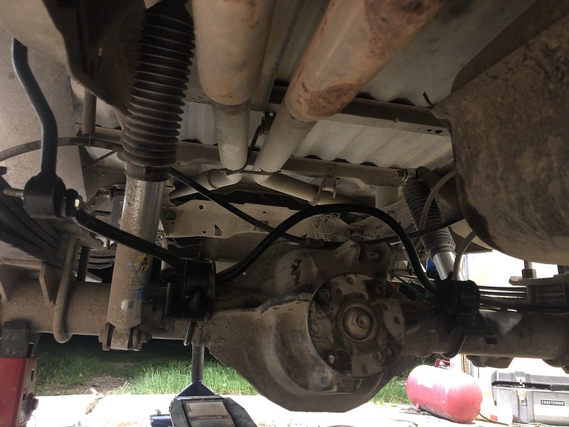

I recently grabbed a factory rear swaybar from a junkyard regular cab Edge to add to my 2010 2wd. I can see where it's supposed to mount up, but getting it up over the rear diff without snagging any lines seems like it's going to be a PITA. Before I take a crack at this, anyone have any tips to make the install easier?

Get the axle clamps kinda snug and about where you think they should go, leave it lose enough to shift around. Then connect the links between the sway bar and the frame. Then snug the clamps on the axle. Watch for rubbing on brake lines.
Pretty much it just takes patience. I would recommend setting up the end links with the bar sitting on the axle and driveshaft. Once that is done, you can work on the u-bolts and brackets that mount the bar to the axle. Only snug things up at first so you have play to allow things to get moved around to set clearances. Especially around the passenger side shock. Once that is all set, you can tighten everything down.
I had to move the gas tank out of the way in order to be able to install the upper stud and nut on the driver's side. The only other way to do it if you don't have what you need to hold the tank up and move it out of the way is to lift the bed.

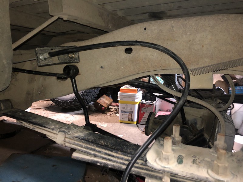

Ok, update - got the bar in. It was much easier trying to position it starting at the driver's side (gas tank side) for some reason. The puzzle worked out better that way. Man, even with the BL that bolt by the gas tank was a b*tch! 🥵 I managed to thread it by hand and then use a ratcheting wrench, but it definitely was awkward. Everything is attached loosely. Does it particularly matter where the brackets are? It seems odd to have it half-on, half-off the diff housing, but that's where it seems to fit best.
That is how it goes. When I was pulling mine I thought someone had it on wrong.
Awesome, thanks for all the help. Yeah, the junkyard in New Mexico I bought it from sent a picture of it mounted on the donor truck, and I was like "are you sure that's a factory install?" As long as it works, I'm good. The bushings all looked good and it doesn't seem like there'd be much of an advantage to poly on this setup anyways, so I just gotta button it down and we'll see how it goes.
