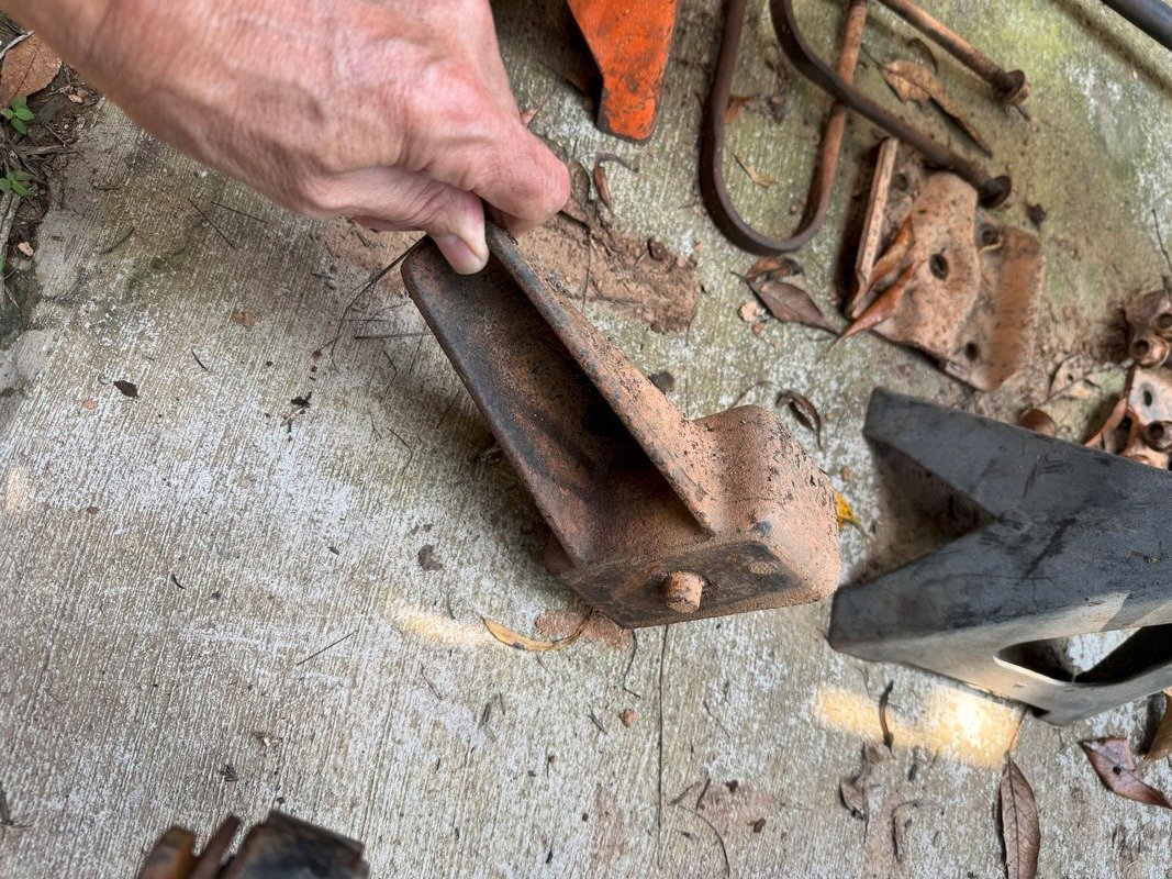

Got a 88 ranger longbed 4x4 . I did a complete rear springs and shackles due to rust out.
about 6 months ago. everything new stock replacement. ever since the ass is jacked
way up. Question: this truck has 3 in blocks under the springs. Does this truck come stock with lift blocks? They were on the truck when I inherited it. This truck is all stock.

Stock, 4x4 trucks came from the factory with 2" blocks. They have wings cast into the side to contact the bumpstop underneath the frame rail directly above.
If they blocks are indeed 3", then no those are not stock and that is why you have the ass end up in the air. No wings on these blocks.
If the blocks are 2.5" wide by 3" tall and have the factory wing, they came from a 2wd F150 and definitely arent stock from your truck.
