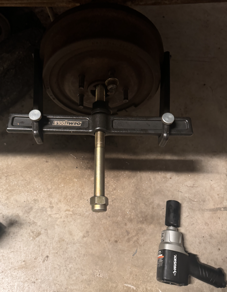

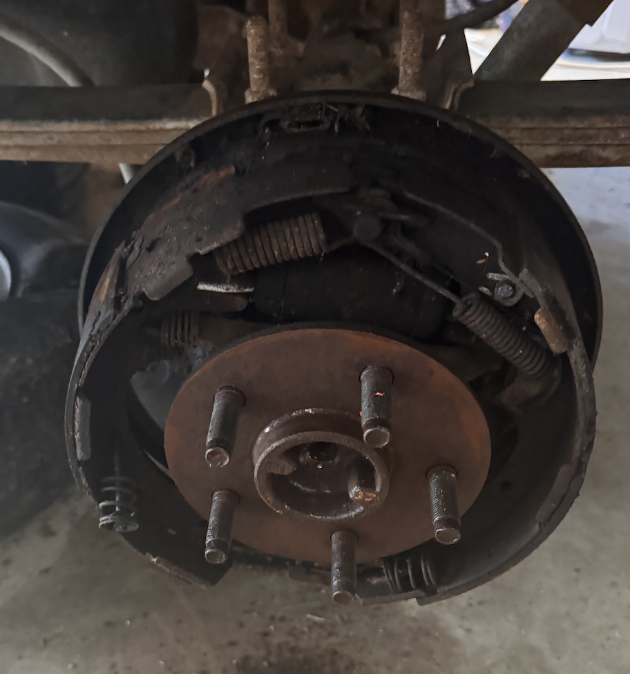

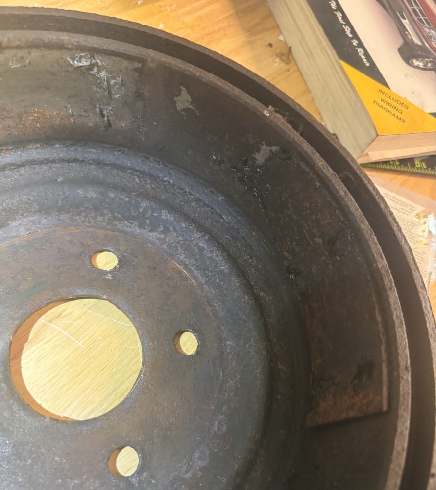

After trying several smaller pullers, I got the heavy duty OEMTools one from Amazon to pull the drums off. After two iterations we have success!! Looks like almost a quarter of a shoe rusted to the inside of the drum, o_O. Which would explain so many things about why the thing didn't want to come off.

Those shoes look new... LOL

why i just cut them off. turning that true will warp the hell out of it in use.
There was a TSB about sealing the holes in the backing plates to prevent that, the left side brakes would get rusty due to water intrusion. I sealer the backing plates on my 2004 when I did the PDI and the original brakes were still in good shape when I traded it toward my 2011. I pulled the drums every May for state inspection, dumped out the dust and put the drums back on. on the 2011, I had to disassemble the rear disc brakes, grind the rust off all the slide points and relube everything every spring.
