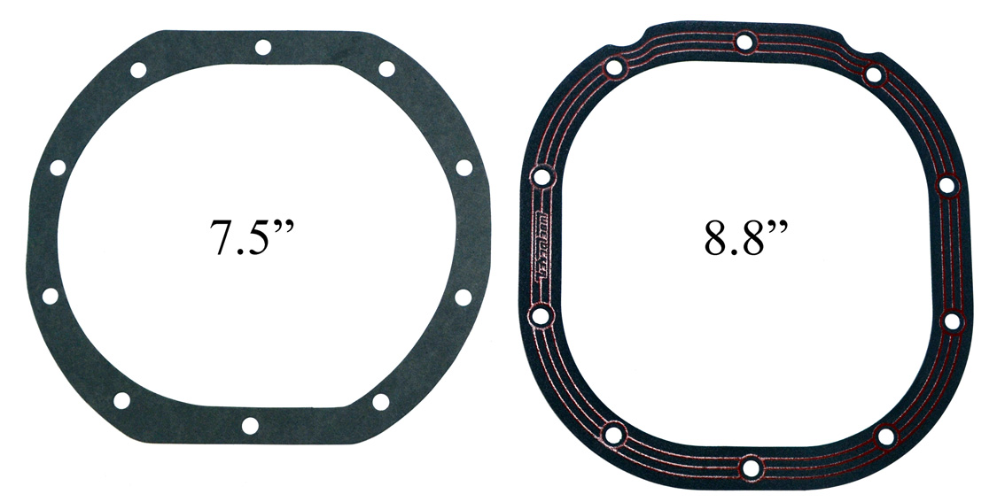

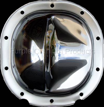

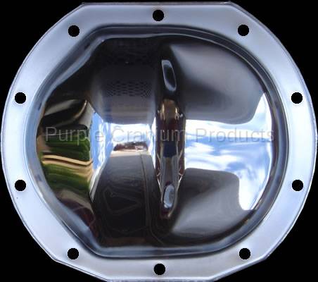

There's a lip going across the bottom of the pumpkin. On a 7.5 is very narrow--like 3/4". On an 8.8, it's wide, like about 2". You can easily tell by looking at that lip.
7.5 Cover
8.8 Cover
