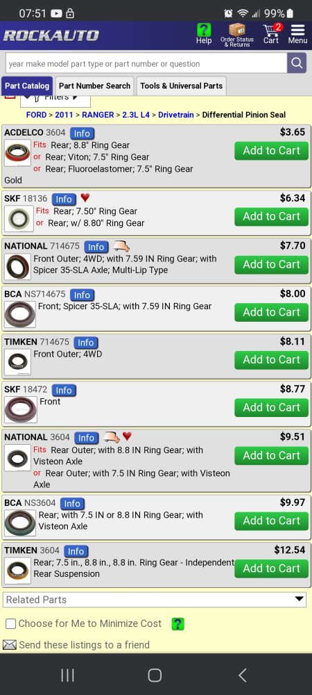

Yes. The seal should fit tight in the bore. You should have to tap it in with a hammer and driver. Here uis a list of seals for that. (Only pay attention to the ones that say rear) it looks like you need a 3604 seal (18136 if you order the SKF)
That 3604 seal was the one that was too big. Thanks though.
