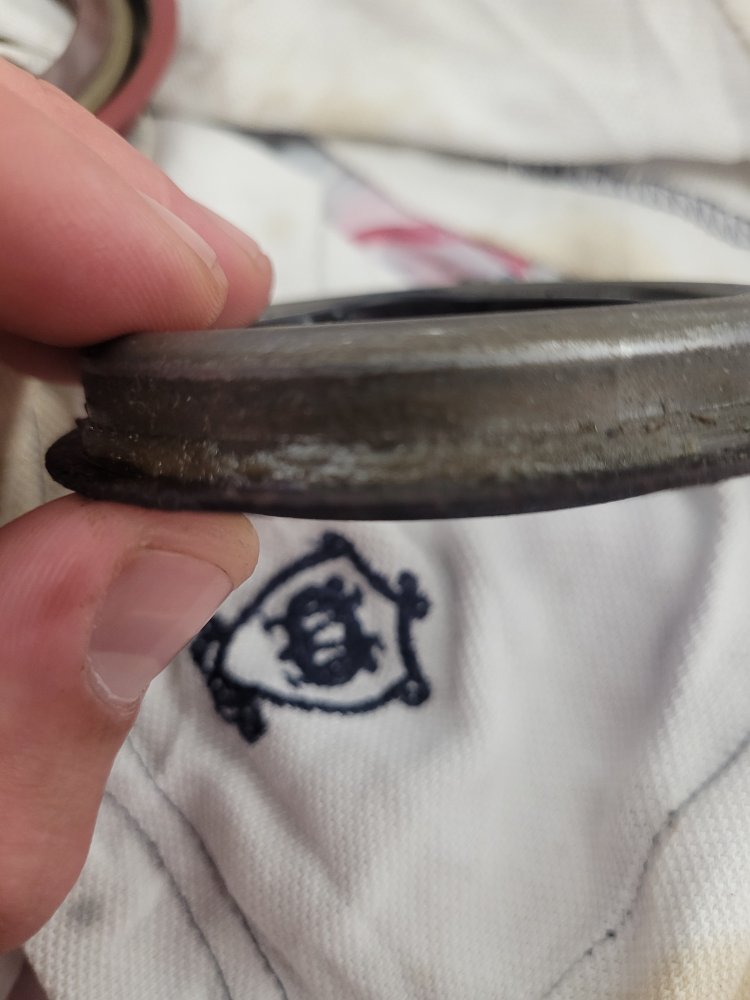

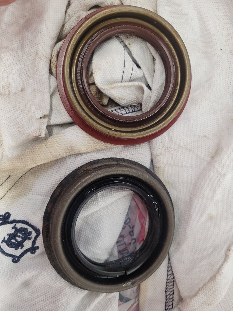

The original seal # is F89W-4676-AB. 1ST picture is the silicone residue on the side of the seal the 2nd is the original next to the 714675 seal that slid right in the housing. The 3rd is the original seal next to the 3604 seal that is obviously much larger.

Ended up ordering my seal directly from Ford and everything went back together smooth. Thanks everyone for the tips appreciate it a lot!
