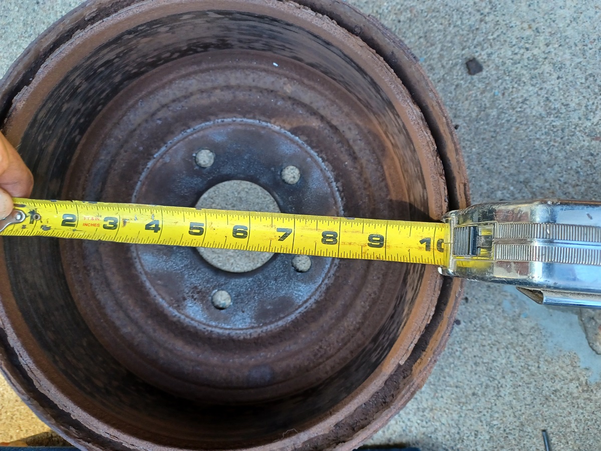

Ok... I am overthinking this again.... but ordered new shoes through Amazon.... and they will be delivered on Tuesday.... but let the paranoia set in.... As I read the forum this morning some of the posts said that most Rangers that are 4x2 (line my 2004) are 9" drums/shoes..... Well..... I actually went out and pulled the wheel and drum off the other day before I ordered and got out my tape measure to be sure.... and I have attached two pictures..... I measured the inside diameter of the drums and it was almost exactly 10 inches..... Please confirm..... PS..... My first car was a 1962 Chevy.... and I replaced the shoes on that several times and also replaced the shoes on a 1949 Ford rear end that I installed on my 1927 Chevy truck... I also have installed shoes several times in the 1960s-70s working for Texaco so this is not new to me... but haven't done it for years now....so I have watched the A1 You Tube video on this several times and the only thing "different" about all this is the self adjuster unit that looks fairly simple... Will do one side at a time and use the other side for reference to confirm everything and will have the video on my cell phone too and hit pause after each step... I even have the brake tools shown except for the spring compressor tool to remove the spring from the backing plate... but have used a regular pliers for this for years as well.... I should be OK... already had the drums off (to measure and take pictures) and blew out the dust (from a distance) so I should be all set..... am I missing anything? and have I got the concept right on measuring to make sure this Ranger requires 10 inch shoes? Please advise.. pictures attached......

You're measuring right... 10 inch drums. Be sure to have them turned... they look hot spotted. Also being from the rust belt... I'm gonna guess the self adjuster is seized... if you can get it apart... wire wheel it and lube it so it turn freely. Also the springs/hardware typically take a beating with the heat (not to mention salt). Be sure to inspect it all really well be for just putting it back on.
I'm not sure of a hard fast rule on what got 10 inch drums... but 8.8 rear end... 4x4.... trailer tow equipped vehicles seem to all have gotten 10 inch drums.
Hey... well first, thanks for confirming the size... I know that it makes sense but honestly, there always seems to be an exception to the rule... For whatever reason, Amazon had a set of Wagner 10" shoes for $17 delivered (prime) free.... they will be here on Tuesday.... and yes, they say "riveted" which is what I wanted...

Thanks again for confirming the 10" drums... I got a little nervous when I read the forum comment about most XL two door Rangers having 9 inch brakes....
