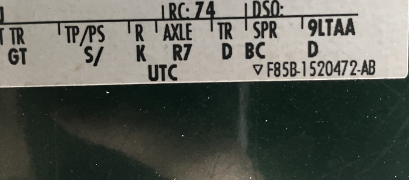

what is the "axle" code on the sticker on driver door (that will tell you if you have a 7.5" or 8.8")... and has the rear axle been swapped to the best of your knowledge (is it way lowered or lifted or such)?
actually probably better to just short cut the door tag and go straight to the axle tag.

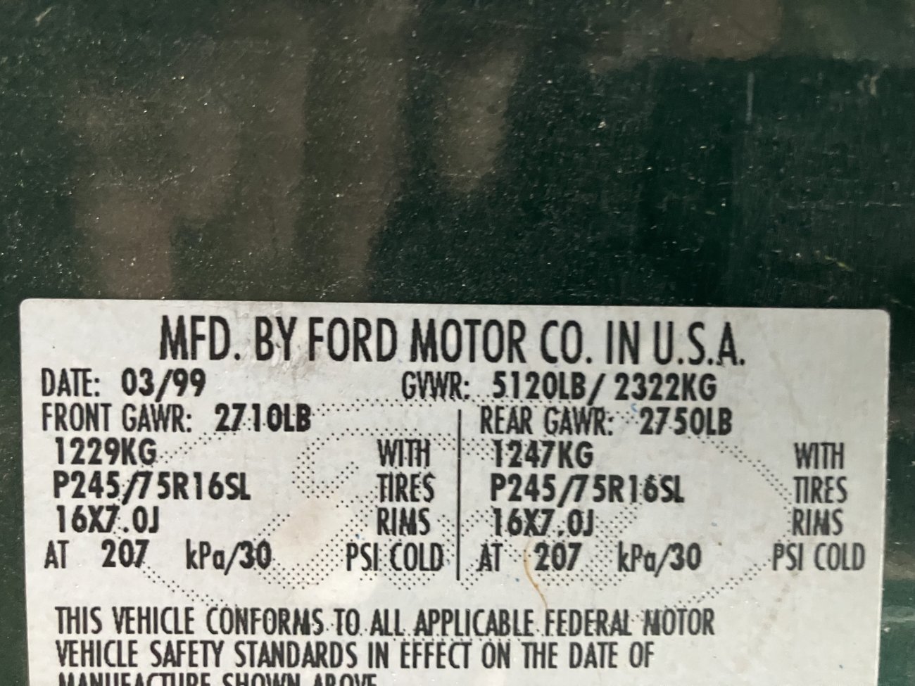

here's the lookup and more info
my mistake. I should have included that. It is stock without a lift or anything
so an R7 would be a 8.8"

as long as you don't have an FX4 package or any other oddball reason to have a 31 spline, you would be a 2.8" tube diameter (might check with a tape before ordering anything you can't return for free or have to mess with shipping etc).
With all that knowledge does it narrow down what the parts stores are offering to just the right choice?
