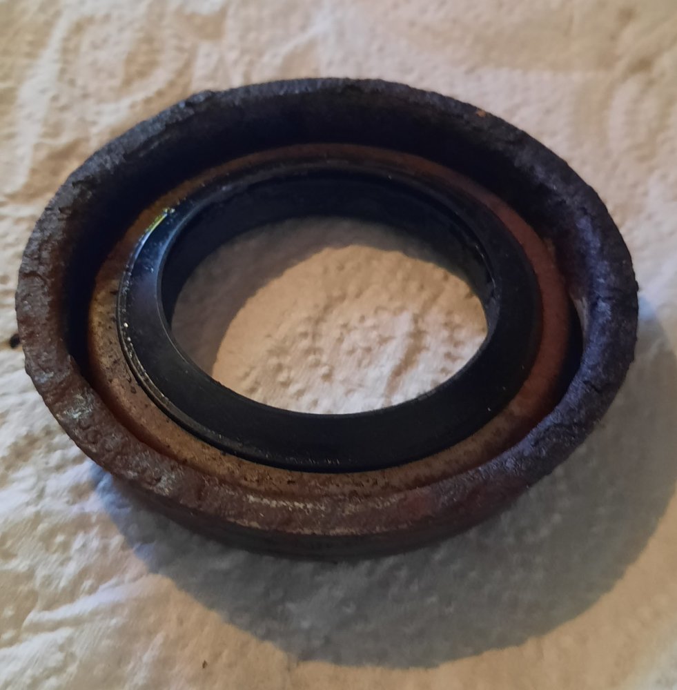

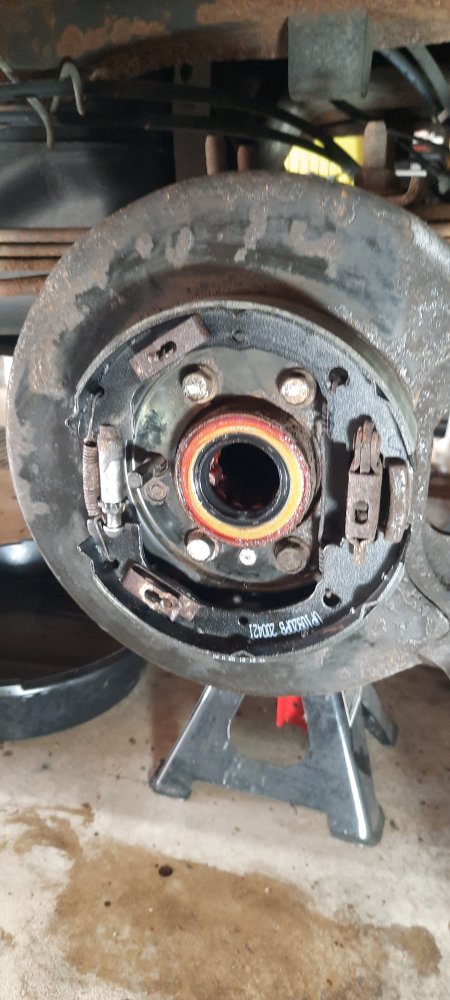

Hello, I am struggling to find a replacement rear axle bearing seal for my 2011 Ranger XLT, 6cyl, 4wd. It has a 8.8 rear end w/ disc brakes. I am in process of replacing the bearing and seal and cannot find the correct seal at any local auto parts store or online. The replacement bearing is national 6408. The shaft diameter where the seal seats is 1.62 OD measured with my calipers, the axle shaft has 28 splines. Can someone help with this?

That looks like the pinion bearing seal, not the axle bearing seal.
I believe the pinion bearing seal has the flange and the axle bearing seals do not.
I do see some listed that look the same as yours, but there are a few different motorcraft part numbers that all look the same.

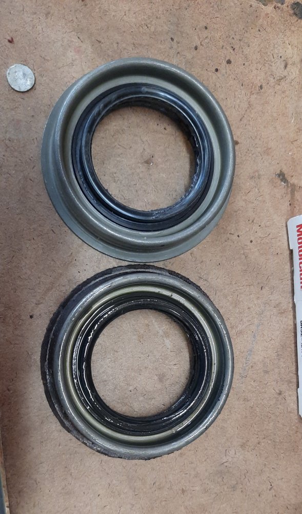

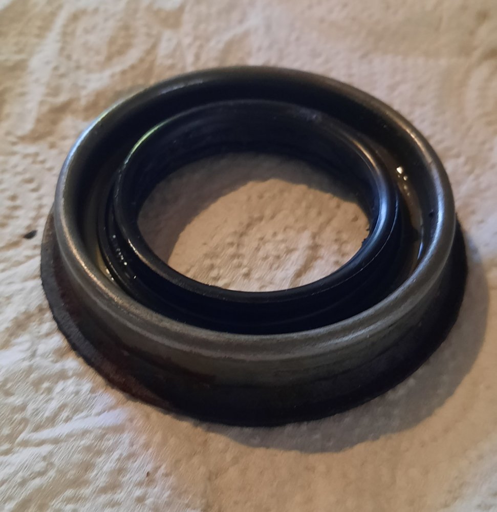

I ended up finding one that fit from Napa, the one that was listed in there catalog for my year did not fit, but the Napa guy found one that did. It is a Napa part no. 27SS2698. It did not have a metal flange like the OEM, but the correct ID and OD and depth.

Earlier this week I ordered a OEM seal from www.bluespringsfordparts.com, the part was listed as (5R3Z-1S177-AA). I did not end up installing this seal since I already installed the Napa seal and needed to get this done. The OEM seal was a perfect match to what I pulled off, it came in as motorcraft BRS-101. That part no. does not come up when I search for my specific year truck on any autoparts website (rockauto, advanced, o-rielly's, autozone, and Napa)

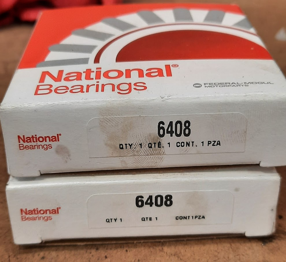

I used national 6408 bearings. You'll definitely want to use a slide hammer to remove, and a bearing seater to install.
I have low miles on mine, only 30k. I bought it and the previous owner said it sat for awhile, so I am trying to address a few issues.
