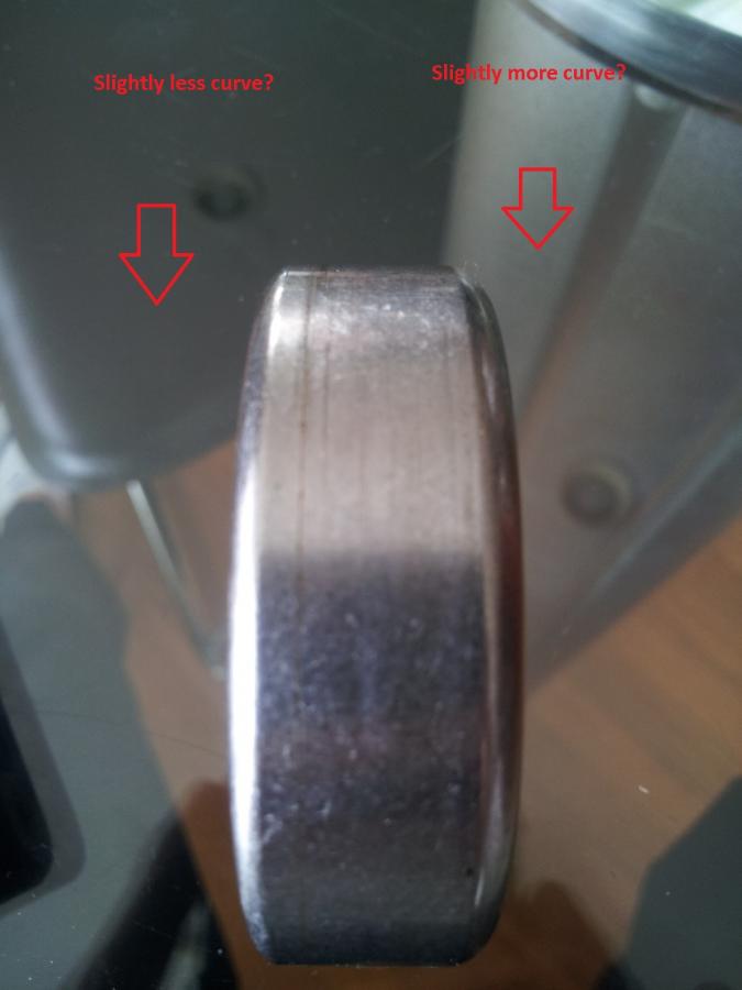

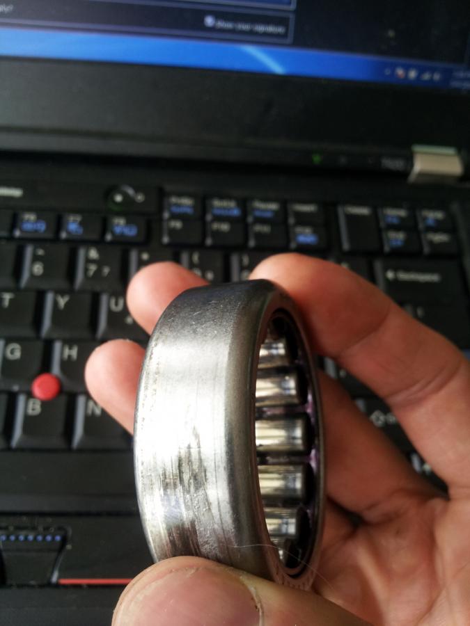

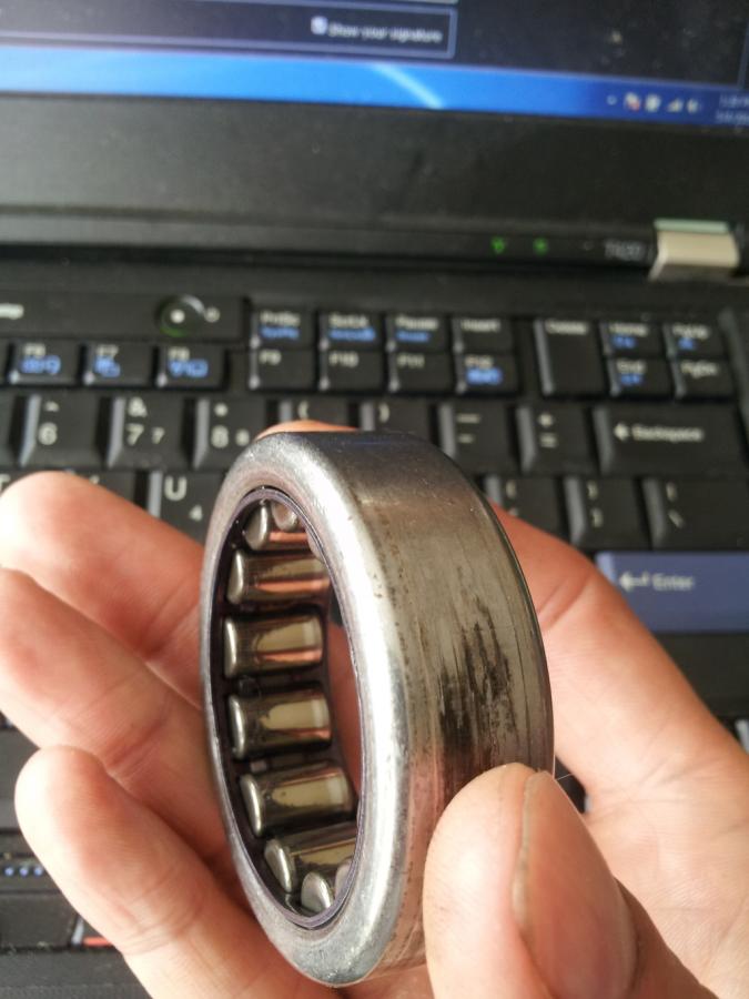

I forgot to note which way I pulled the bearing out and it appears that one side is slightly more curved than the other.
does it matter which way the bearing is put back in?

I'm not sure if it matters? But I've always done these with the numbers/marking facing out.

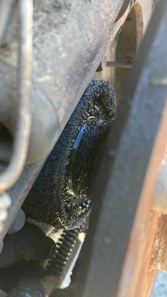

1. my passenger-side rear-seal leaks. the driver-side rear-seal seems fine. "if it aint broke, dont fix it" my gut is telling me to leave the left side stock. order the parts for the left side, but leave them on the shelf for now... and ill know how to replace them late when the time comes.
