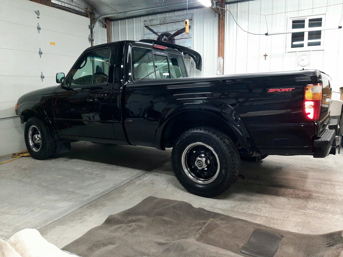

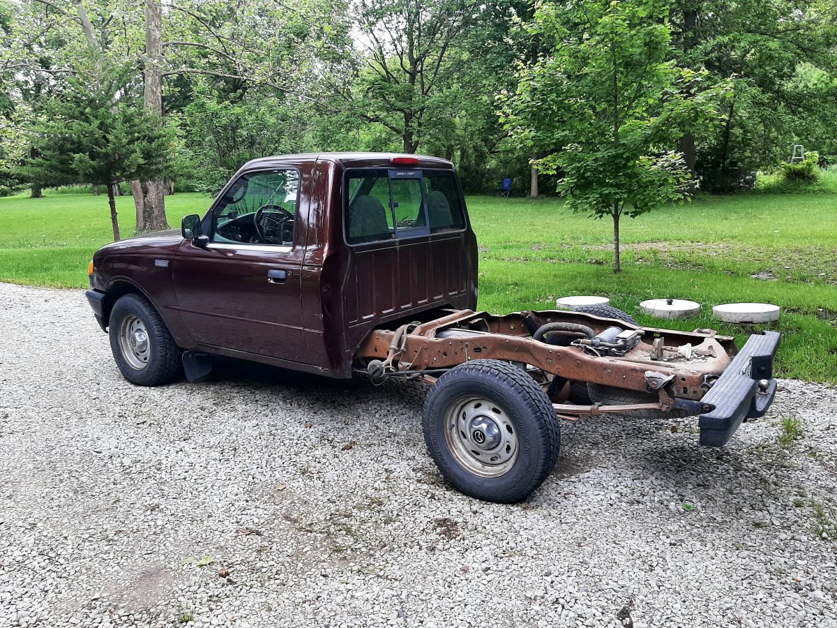

So all you swap vets please convince me not to do this myself. I'm not a professional mechanic and cars are not my favorite thing to work on. I am very mechanically inclined and have most of the tools and an indoor shop to work in. I'm retired and have ample time. I'm up to the challenge. I inherited this 2003 60k mile B2300/Ranger from my Uncle and fixed up the interior and did new paint in his honor. See the pics. I was hoping I could tolerate the squirrel cage engine in it but no. So if I'm going to upgrade this would be the last step to have a unique show ready truck. I want to go low and 2wd. Looking for recommendations for easiest/best plug and play V8 drive train. Not necessarily looking for max hp but serious power upgrade. Looking for better ride so brake and suspension recommendations would be appreciated. I will likely convert the truck over to a full Ranger look or a clandestine B2300. In the end.
