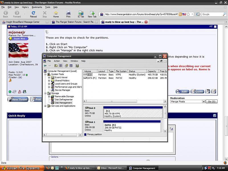

These are the steps to check for the partitions.
1. Click on Start
2. Right Click on "My Computer"
3. Click on "Manage" in the right click menu
4. Click on "Disk Management"
5. Look at how many partitions are there. You should see 1 C: partition and maybe your CD drive depending on how it is interfaced.
I attached a screen shot of what Disk Management looks like.

ok i checked and there is about 400 gb unallocated. Now what?
i just searched online and figured it out. I deleted the D drive cause it was empty anyway, then extended the volume so now im good.
