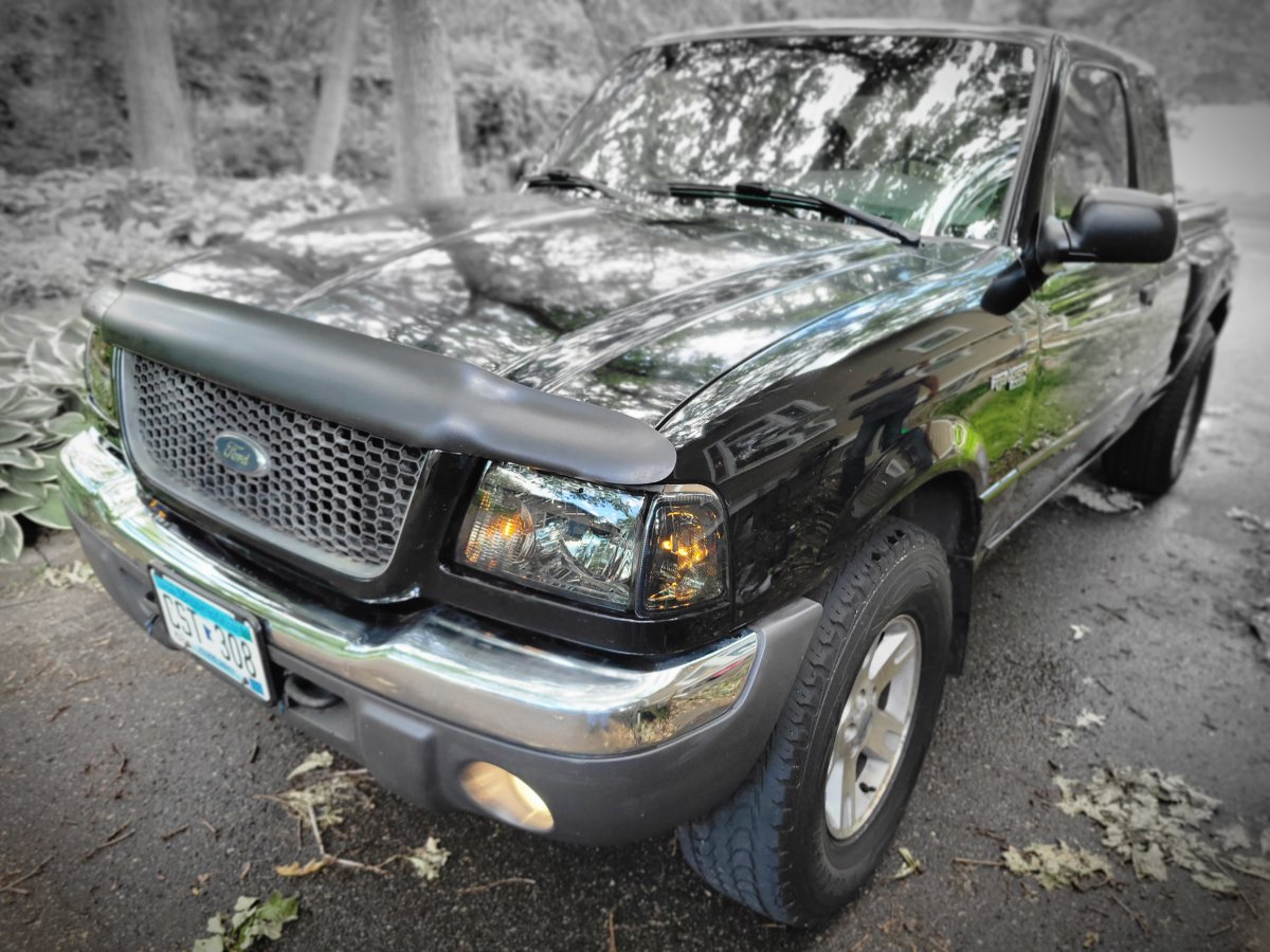

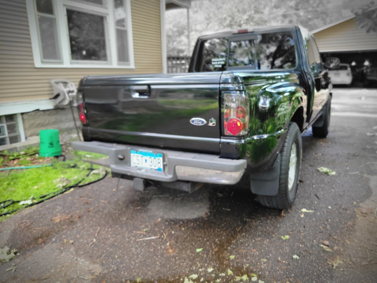

So the garage fire ranger returned to my driveway today. it was due for a wash. Here's a couple gratuitous fotos. Here's one of the tail gate we painted. It looks pretty good except it doesn't quite match as well as we wanted. it hasn't been clear coated yet either. He said the difference is so subtle most would never notice. Maybe he's correct.
He's still pretty happy. This is a 2001. He said it's is a work truck anyway. We will be doing more in the future. i will keep you all posted.

Once again, this is far from a show room finish. It's a little hard to show all of the imperfections. If I can, I will in future posts.
It looks better than the roof of mine which is peeling paint like a bad sunburn.
I've been spaying it with autozone colormatch spray paint.
I haven't tried Autozone but I had bad luck with Duplicolor. The spray is too fine and too thin to lay it in wet, except in small areas. Since the Rattle Can Ranger is black, it's easier to get a close match. So we used Rustoleum Automotive instead. It delivers a much heftier spray pattern and covers larger areas without dry spots.
If I had to match a color, I would use Rustoleum first, lay it in for good coverage, and make the surface very smooth, then wet sand it down with 1,000 or 2,000 grit. (Maybe even 3,000). Then I would spray with one of those little cans like Duplicolor.
