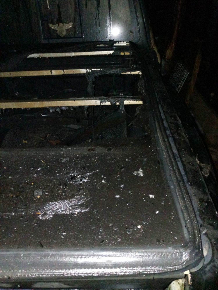

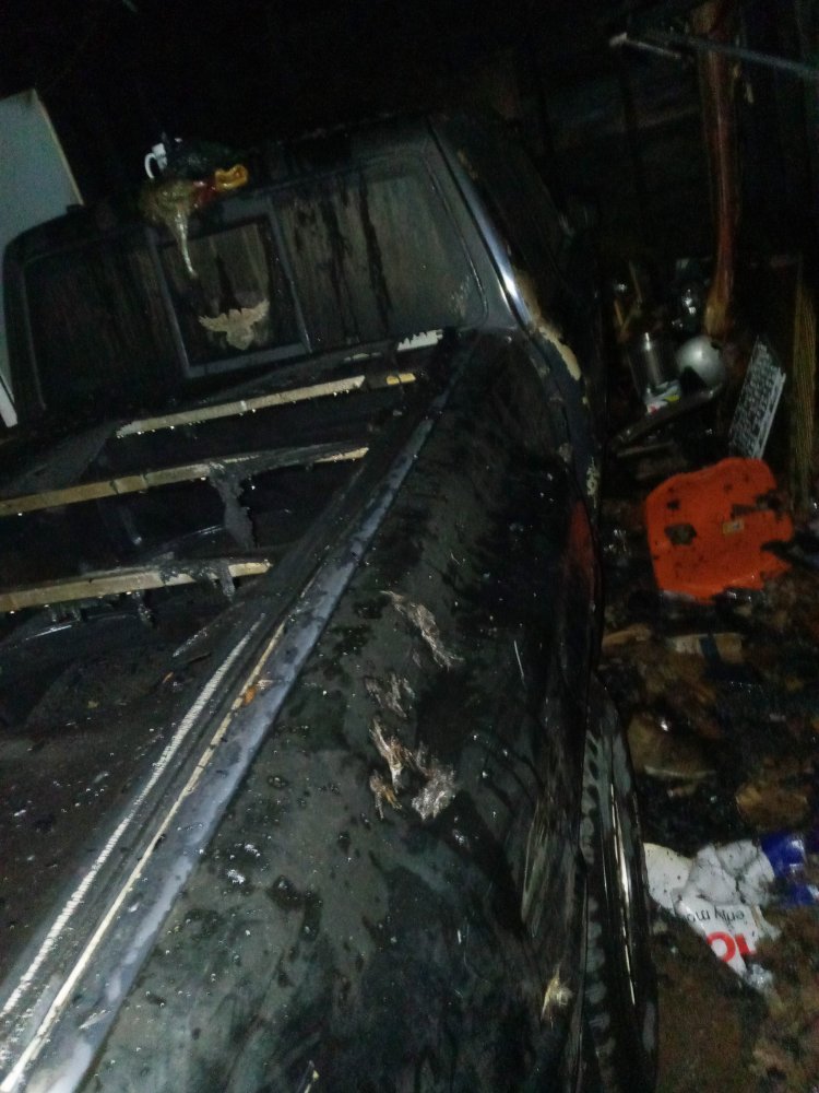

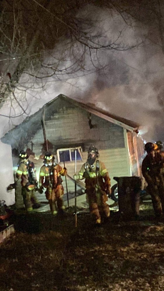

This story begins with a fire that burned down my friend's garage. His Ranger was inside. Lucky for him the fire department arrived within minutes. The garage was in flames by then.
They put the fire out right away, but his 2002 Ranger XLT was still inside. It was a mess. The asphalt shingles had turned molten and dripped down on the truck.
Every horizontal surface burned. The tonneau cover had caught fire.
What didn't burn formed a heavy coating of residue, some of which had bonded to the paint work.

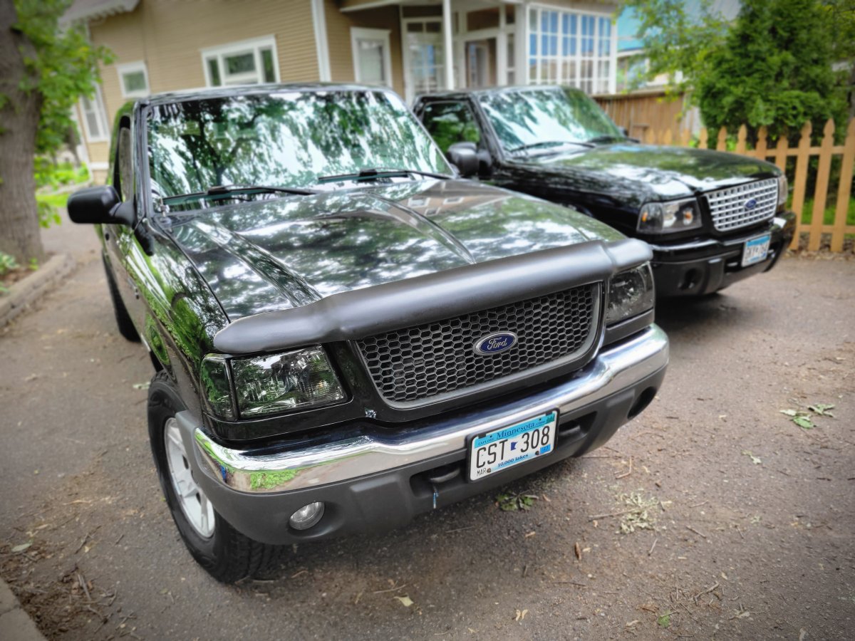

We went to work right away, power washed what we could. The whole thing still smelled like fire, even from a distance. I clay bar cleaned it, then buffed every surface down. I washed away the more stubborn stuff with acetone. Since then, we have been working one panel at a time, sanding, priming, sanding again, painting, and finishing with a couple coats of clear.
Believe it or not, our efforts have paid off. We have a long way to go, but it's beginning to look like new again.
Maybe we should have worked on the whole truck at once and sprayed it with a cup gun, but our schedules are too busy. We can only give this restoration a few hours at a time. We still have a long way to go, but if you are interested, I will keep you posted.
I am amazed the truck survived. I'd like to see more pics from different angles to see the new paint please.

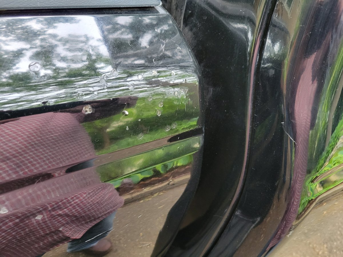

This closeup is an example of what we are up against. This is a photo of the top edge of the pickup bed just behind the cab. The surface is pitted and bubbled. So we will sand that down maybe with an orbital sander, prime, and paint and blend.

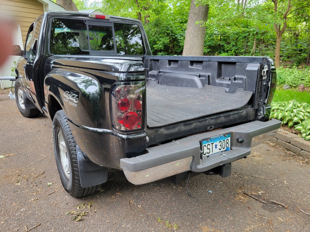

Here you can see the back end. The left side of the pickup bed looks pretty good. We didn't have to do too much to it: several wipes with alcohol, a clay bar job, and two passes with a buffer and some polishing compound. The buffer actually made all the difference.
It's still scratched from falling debris. The roof of the cab has been painted. The tail lights looked bad so my friend purchased new ones.

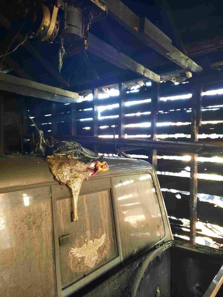

Was that a shingle? I thought it looked like a rubber chicken that melted.
