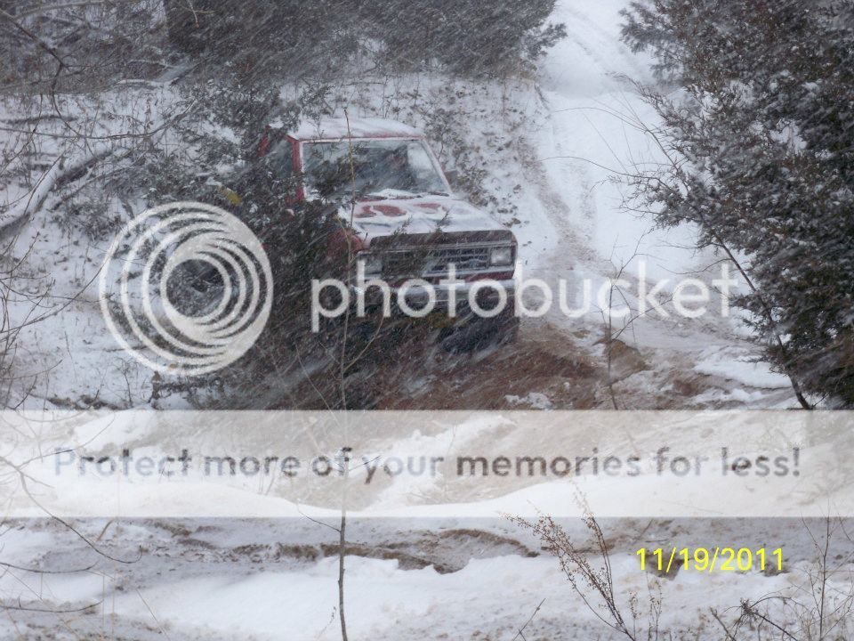

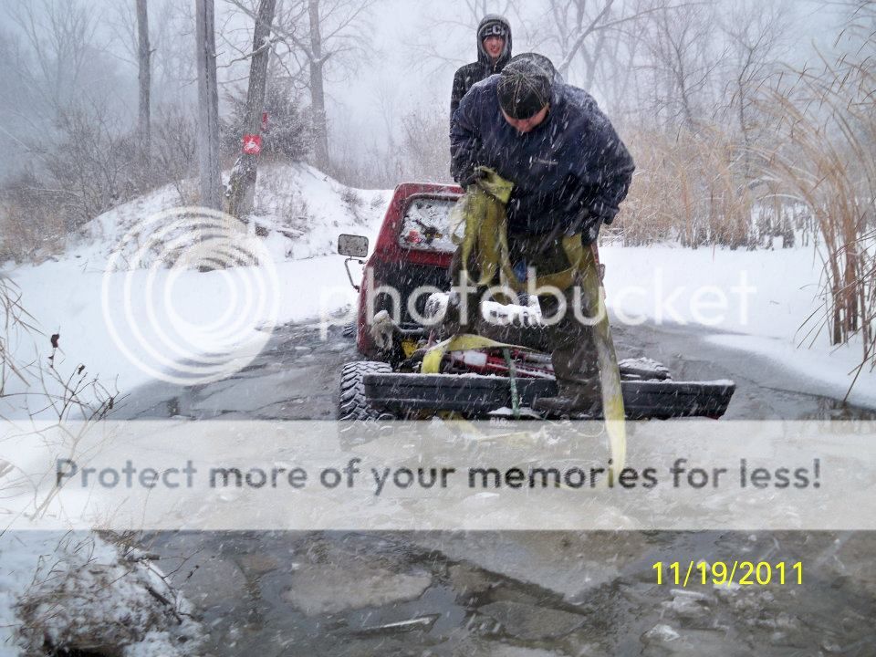

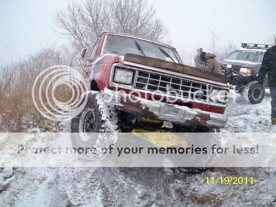

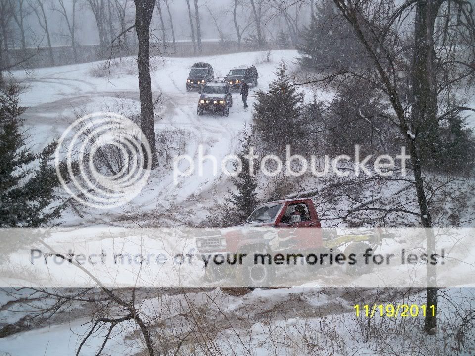

took the ranger out on its first real offroad adventure, it was my ranger 2
Xj's and 1 ZJ(?). did pretty good for its first trip getting real worked, broke a lock out hub and short axle shaft on pass side, but looks like the spicer 760 held up. I really need to firgure out the transfer case, no 4 low. it shut off a few times when rolling down hills and stopping. had too kind of drive it 2 footed
we thought the snow was suppose too hold off til the evening, but it started at 8 am
