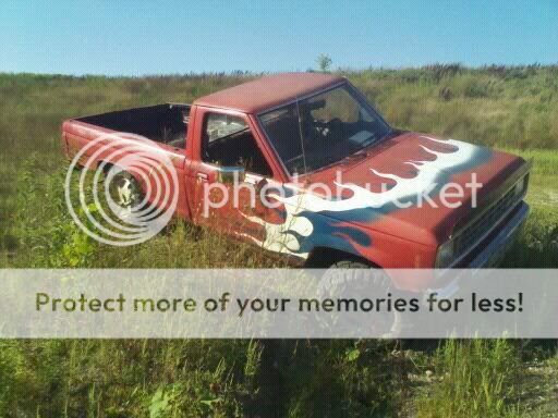

So I started building my new 84 Ranger. As posted in another thread my 96 ranger burned up.http://www.therangerstation.com/forums/showthread.php?t=115309
Just had the 84 under the knife for about a month, sorry pretty much no pics. But I will work on it, well heres a list of what I've done. front to back

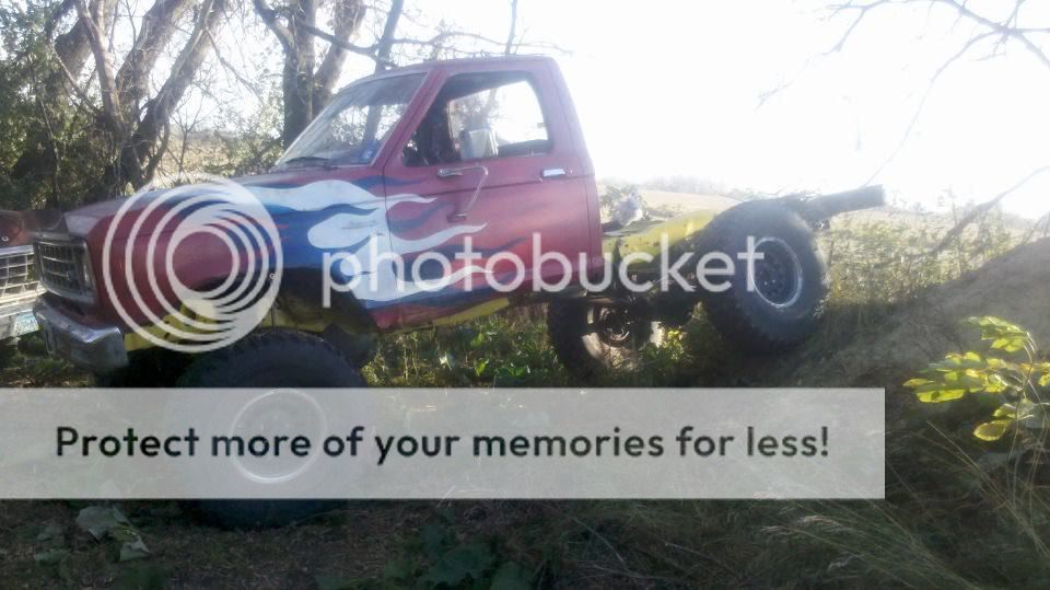

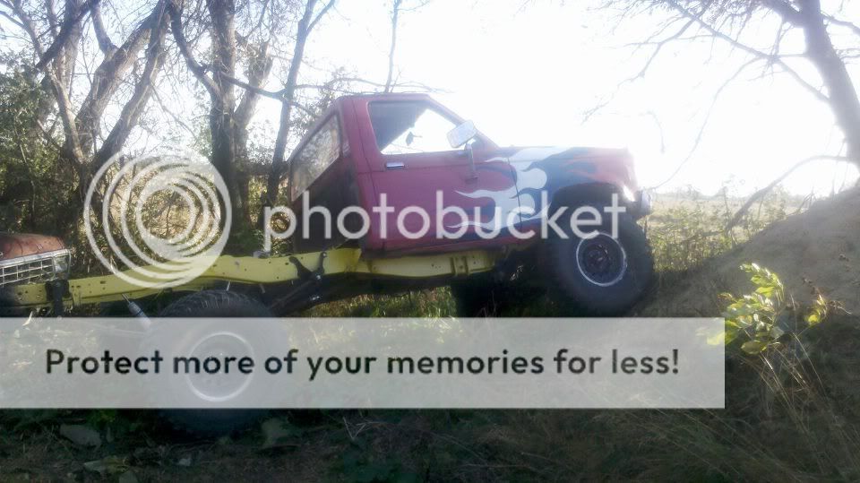

went to a little mud run at my buddy's place and got stuck
Flexing
