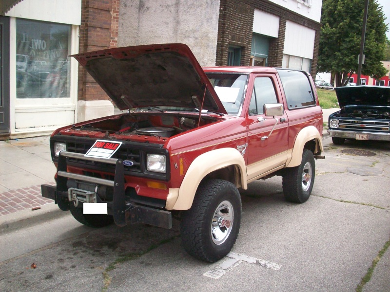

they posted this bronco 2 on a fullsize bronco chassis.
seems like it answers all of your questions.
attachment.php
note the fender flares.
attachment.php
That's a '76 Bronco... not a fullsize.
yeah...2 inches more per side.
i thought it was easy to visualize..
yeah...calling an eb fullsize over a 150 based unit is inaccurate.

It is never a bad idea to ask for input, a tape measure won't tell you this frame fits better than that frame. There is more to it than track width.
The one pictured has later model fullsize truck wheels that are wider and probably have a different offset than factory '76 Bronco wheels so it might not be as far off as you think.
