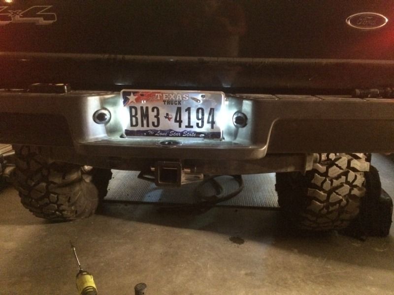

I then ordered 2 winches. A 9,500# Smittybilt XRC with synthetic for the bumper and a 4,500# champion to go out the back as an emergency. I also swapped it to synthetic. My rear winch comes from behind the license plate so I had to make a bracket

The alternator came from Singer. I bought it from another member but it is a direct replacement. Also includes an extra smaller pulley to put out 30-40 more amps at idle. Contact I was told over there was Mike.
