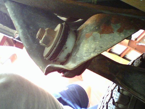

Why don't you fab up a d44 style radius arm? They use bushings. Forgive me if this has already been discussed but I was just wondering.
Is that going to work?
Not trying to be mean, but it kinda looks like a cluster. I'm hoping something is missing in translation.
Why don't you fab up a d44 style radius arm? ...

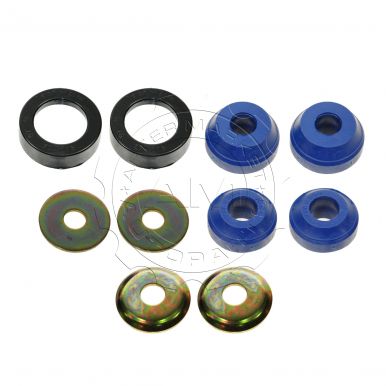

This is the answer if you want to use bushings. They use a setup similar to this:
With this type of a bushing:
That is a proven setup, and looks to be considerably less complicated.
I agree with these guys. RSH I can get you some pictures of different angles of the radius arms/bushings/mounts on my D44 under my '79 for you today.
